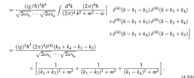

See attached - quantum theory. first line.
Setting ##a=k_1+k_2## and ##c=-k_3-k_4##
##\delta ( -a -c ) ## gives me the correct expression of ##\delta(k_3+k_4-k_1-k_2) = \delta ( -k_3 - k_4 + k_1 + k_2) ##
whereas
##\delta(a-c)## gives me ##\delta(k_1+k_2+k_3+k_4)##
Well, that step is wrong. Without seeing the rest of the argumentation it is difficult to tell you what is going on.

Fact:
$$\int \delta(x-a) \delta(x-c) \, dx = \delta(a-c) = \delta(c-a). $$
You have been shown at least two correct, independent proofs of that fact. If you are reading an article that says something else then that article is wrong!
