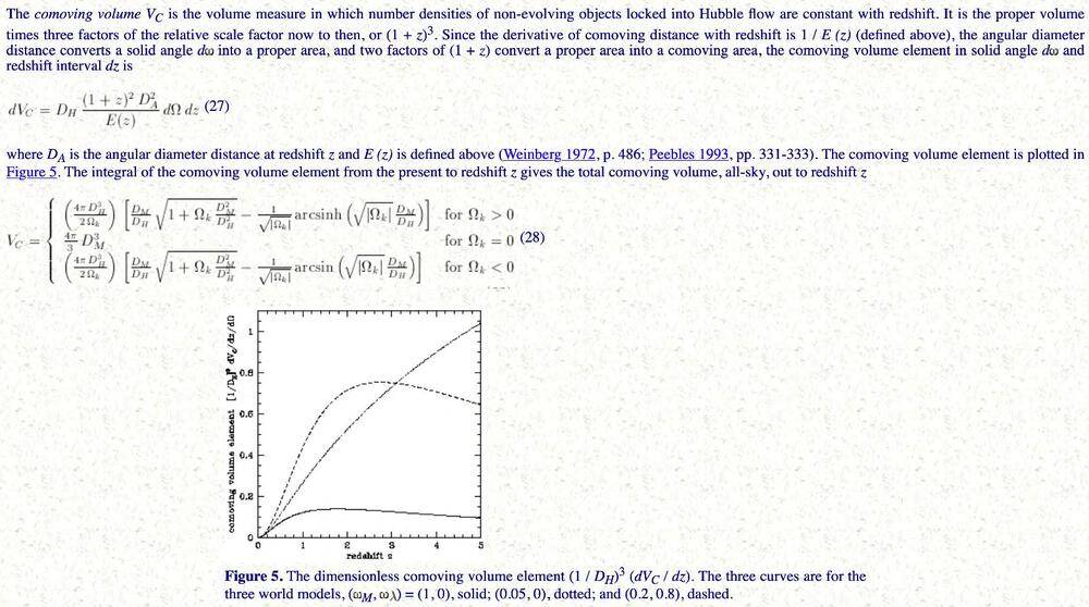

Maybe I have found a partial explanation to my issue to determine the expresion of this volume between 2 redshifts. Here below a formula :
Graph of the dimensionless comoving volume element (1/D_H)^3 (dV_C/dz) against redshift z from 0 to 5, with three curves for different world models; the solid curve stays lowest, the dotted curve rises then falls, and the dashed curve peaks near z of 2.
The main expression to keep in mind is :
##d V_{C}=D_{H} \frac{(1+z)^{2} D_{A}^{2}}{E(z)} d \Omega d z\quad(3)##
1) Could anyone explain me please the different justifications to introduce all the factors implied in this expression ?
2) I have not yet with this expression the same expression (1) at the beginning of my post, so could anyone manage to find (1) from (3) ? Any help would be fine, I am stucked for the moment.

Ok, having taken a look at both references (the Hogg web page and the Euclid paper) and compared them, I think I can answer a few questions.
fab13 said:
Is it right to write :
##\dfrac{1}{\sqrt{1-\kappa r^{2}(z)}} \dfrac{c \mathrm{d} z}{H(z)}=\mathrm{d} r## ??
No. Note that in the Euclid paper, when they go from equation (14) to equation (15), they say that step is only valid for a spatially flat universe, ##K = 0##.
If you look back at equation (12) of the Euclid paper, you see:
r(z) = \frac{c}{H_0} \int_0^z \frac{dz}{E(z)}
which, using an earlier equation, can be rewritten slightly to
r(z) = \int_0^z \frac{c dz}{H(z)}
And since by definition ##r = \int dr##, we have
dr = \frac{c dz}{H(z)}
This is valid regardless of whether the universe is spatially flat, open, or closed; so the counterintuitive part here is that the curvature factor ##K## does not appear explicitly. But if you look back at the equation for ##E(z)## (which is included in ##H(z)##), you will see that it has a term under the square root that involves ##K##, so the curvature factor is still being taken into account.
Now, what does ##r (z)## represent? It is the "comoving distance" to an object with redshift ##z##. Let's unpack what that means:
(1) "Comoving" means that this is not a proper distance; it is not what you would read off, say, a very long tape measure stretched between you and the object. It is the difference in the comoving coordinate ##r## between you and the object. (You are assumed to be at ##r = 0##.) This assumes that both you and the object are comoving objects, i.e., you are both moving along with the Hubble flow, which means both of your comoving ##r## coordinates are constant with time. So the comoving distance between you is also constant with time; it does not increase as the universe expands. (The usual term for the distance that does increase as the universe expands is "proper distance".)
(2) So what ##r(z)## is actually doing is "translating" a redshift ##z##, which is what we directly observe, into a difference in comoving coordinates, which is what can easily be plugged into the mathematical model we use to describe the universe. Note that we can do this between any two objects with different redshifts; one of the objects does not have to be us at ##r = 0##.
Now, given that, what is a "comoving volume"? As I read the references, what they mean is basically what I described in post #22. To recap briefly: we pick two different redshifts, ##z_1## and ##z_2##; we obtain the difference in comoving distances ##r(z_1) - r(z_2)##; we integrate that over some solid angle ##\Omega## to get a volume, using some relationship between radial comoving distance and transverse comoving distance (the specific relationship depends on whether the universe is spatially flat, open, or closed) to convert the solid angle to a comoving area. Note the key phrase in the Hogg article: "the volume measure in which number densities of non-evolving objects locked into Hubble flow are constant with redshift". This can't be true of a volume that increases as the universe expands, because number densities for such a volume decrease as the volume increases. Basically, the purpose of comoving distance and comoving volume is to remove the effects of the expansion of the universe in order to make certain kinds of analysis, the kind that these cosmologists are trying to do, simpler.
Let's compare this expression with the one in the Euclid paper:
V_C = \Omega \int \frac{r^2(z)}{\sqrt{1 - K r^2(z)}} \frac{c dz}{H(z)}
We can rewrite this in terms of ##E(z)## instead of ##H(z)## (and also pull the constant ##c## outside the integral):
V_C = \frac{c}{H_0} \Omega \int \frac{r^2(z)}{\sqrt{1 - K r^2(z)}} \frac{dz}{E(z)}
We can substitute ##D_H = c / H_0## (as defined in an earlier page of the Hogg article):
V_C = D_H \Omega \int \frac{r^2(z)}{\sqrt{1 - K r^2(z)}} \frac{dz}{E(z)}
But remember that above we said we wanted to integrate over solid angle; we want to know how comoving volume varies with solid angle as well as with radial comoving distance. So we need to pull ##\Omega## inside the integral:
V_C = D_H \int \frac{r^2(z)}{\sqrt{1 - K r^2(z)}} \frac{dz}{E(z)} d\Omega
We can rewrite this as an equation between differentials (i.e., undoing the integral so we have an equation for the differential of ##V_C##:
dV_C = D_H \frac{r^2(z)}{\sqrt{1 - K r^2(z)}} \frac{1}{E(z)} d\Omega dz
And, finally, we can observe that
\frac{r^2(z)}{\sqrt{1 - K r^2(z)}} = \left( 1 + z^2 \right) D_A^2
And that gives us the equation in the Hogg article.
That last observation is the difficult part, but hopefully you can see why it's true by reading through all the pages of the Hogg article (pages 5 and 6 in particular might be helpful).

Hello PeterDonis,
thanks for your answer. Everyting is right except the demonstration of the last equation, i.e :
$$\frac{r^2(z)}{\sqrt{1 - K r^2(z)}} = \left( 1 + z^2 \right) D_A^2$$
I know that ##D_A(z) = \dfrac{D_C}{1+z}## but I can't conclude with the presence of ##\dfrac{1}{\sqrt{1-Kr^2}}.##
Could tell me more please about the trick to apply to find :
##\dfrac{r^2(z)}{\sqrt{1 - K r^2(z)}} = \left( 1 + z^2 \right) D_A^2##
No, everything is right including the last equation.
They are both equivalent to the square of the transverse comoving distance ##D_M##, which is described in section 5 of the Hogg article you linked to. The equivalence ##D_M = \left( 1 + z \right) D_A## is from section 6 of that article. The equivalence ##D_M = \dfrac{r^2(z)}{\sqrt{1 - K r^2(z)}}## follows from the definition of ##D_M## given in section 5.
Sorry, there was a typo from recent posts, the expression to demonstrate is :
##\dfrac{r^2(z)}{\sqrt{1 - K r^2(z)}} = \left( 1 + z \right)^{2} D_A^2##
and not ##\dfrac{r^2(z)}{\sqrt{1 - K r^2(z)}} = \left( 1 + z^2 \right) D_A^2##
