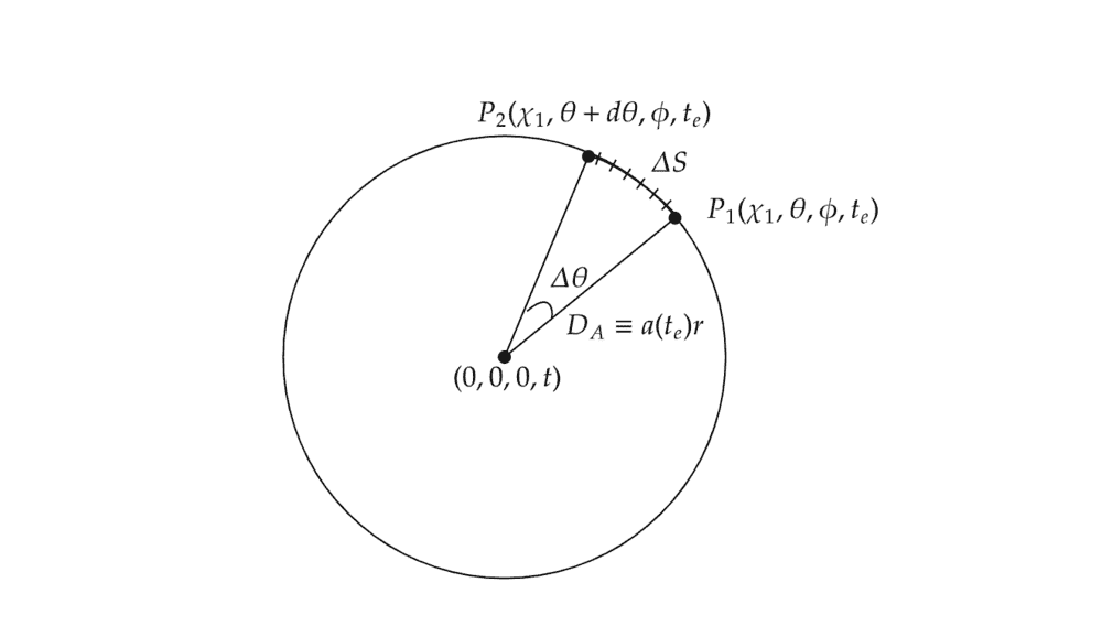

I just want to write some expressions, but I hope it will clear things up. There are indeed two co-moving coordinates. The first one is ##\chi##, and the second one is ##r##.
Now ##r## represents the transverse co-moving coordinate. The FLRW metric (in terms of the ##r##) can be written as
$$ ds^2 = -c^2dt^2 + a^2(t)[\frac{dr^2}{1-kr^2} + r^2d\Omega^2]~~~~(1)$$
where
$$k =
\begin{cases}
-1, & \text{Hyperspherical} \\
0, & \text{Euclidean} \\
+1, & \text{Spherical}
\end{cases} ~~\text{and}~~d\Omega^2 = d\theta^2 + sin^2(\theta)d\phi^2$$.
There is also another co-moving coordinate, ##\chi##, which represents the line of sight co-moving coordinate. Line of sight co-moving coordinate defined as
$$d\chi = \frac{dr}{\sqrt{1-kr^2}}$$By taking the integral of both sides, we obtain$$\chi \equiv \int_0^r \frac{dr}{\sqrt{1-kr^2}} = \begin{cases}
sinh^{-1}(r) & k= -1 \\
r & k = 0 \\
sin^{-1}(r) & k = +1
\end{cases}$$Or we can take the inverse of the above equality and write$$ r \equiv S_k(\chi) =
\begin{cases}
sinh(\chi) & k= -1 \\
\chi & k = 0 \\
sin(\chi) & k = +1
\end{cases}$$In this case, equation (1) can be written as,$$ ds^2 = -c^2dt^2 + a^2(t)[d\chi^2 + S_k^2(\chi)d\Omega^2]$$
The most important part is actually realizing that, Hoggs is using ##D_C## and ##D_M## instead of ##\chi## and ##r##.
$$r \equiv D_M \equiv S_k(\chi)$$
and
$$\chi \equiv D_C$$
So, Hoggs is using a different kind of notation that's all.
In this case, you will also realize that,
D_A = \frac{\Delta S}{\Delta\theta} = \frac{r}{1+z} \equiv \frac {S_k(\chi)}{1+z}
\equiv \frac{D_M}{1+z}$$

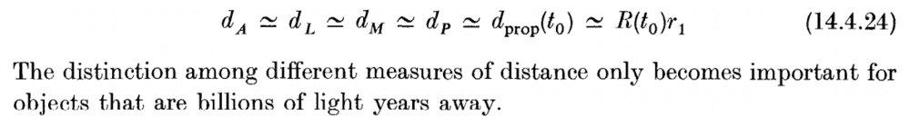

See this from Weinberg 1972
and this is actually also referred in the Hogg's Paper.
Let us refer, basic, old comoving radial coordinate ##r##. In this case the co-moving separation between to co-moving observers is
$$c \int_{t_e}^{t_0} \frac{dt}{a(t)} = \int_0^r \frac{dr}{\sqrt{1-kr^2}}\equiv D_C$$
And the transverse comoving distance is actually just ##r \equiv D_M## (see above pictures)

1) I can see these 2 definitions of comoving distance (line of sight and transverse) lead to different subtilities.
Up to know, I have always considered the variable "r" as a coordinate in the metric :
$$ds^2 = -c^2dt^2 + a^2(t)[\frac{dr^2}{1-kr^2} + r^2d\Omega^2]\quad(1)$$But you will surely tell me this expression is just a particular case, the flat one.
I don't agree for the definition about Hogg's paper when he says that :
5 Comoving distance (transverse)
The comoving distance between two events at the same redshift or distance but separated on the sky by some angle δθ is DMδθ and the transverse comoving distance DM (so-denoted for a reason explained below ) is simply related to the line-of-sight comoving distance DC :
D_{\mathrm{M}}=\left\{\begin{array}{ll}
D_{\mathrm{H}} \frac{1}{\sqrt{\Omega_{k}}} \sinh \left[\sqrt{\Omega_{k}} D_{\mathrm{C}} / D_{\mathrm{H}}\right] & \text { for } \Omega_{k}>0 \
D_{\mathrm{C}} & \text { for } \Omega_{k}=0 \
D_{\mathrm{H}} \frac{1}{\sqrt{\left|\Omega_{k}\right|}} \sin \left[\sqrt{\left|\Omega_{k}\right|} D_{\mathrm{C}} / D_{\mathrm{H}}\right] & \text { for } \Omega_{k}<0
\end{array}\right.
where the trigonometric functions sinh and sin account for what is called "the curvature of space." (Space curvature is not coordinate-free; a change of coordinates makes space flat; the only coordinate-free curvature is space-time curvature, which is related to the local massenergy density or really stress-energy tensor.) For $\Omega_{\Lambda}=0,$ there is an analytic solution to the equations
especially :
Indeed, by definition, the physical distance between 2 objects of same redshift is like the physical distance between 2 points on a circle, so we should have instead :
$$D_\text{physical}=D_C\delta\theta$$
and not
$$D_\text{physical}=D_{M}\delta\theta$$
where DC is the radial comoving distance (or yet line-of-sight comoving distance).
Why did he use DM instead of DC ?
2) Same thing happends with the Angular Diameter distance :
we should have ##D_A=D_C/(1+z)## where ##D_C## represents the line-of-sight comoving distance.
This is by definition the distance of observer from the object began to emmit.
Hogg defined it with : ##DA=D_M/(1+z)##
It should be : ##D_A=D_C/(1+z)##
As a conclusion, why give 2 definitions for comoving distance ? we can deduce the transverse comoving distance from line-of-sight comoving distance by just multiplying with a little angle δθ.
Why couldn't we write directly only one comoving distance ##D_C## (the most common I would say) defined like this below :
Hyperbolic Universe :## \Omega_{k}^{0}>0##
D_{h}=\frac{c}{H_{0} \sqrt{\Omega_{k}^{0}}} \sinh \left[\sqrt{\Omega_{k}^{0}} \int_{0}^{z_{e}} \frac{\mathrm{d} z}{\left[\Omega_{m}^{0}(1+z)^{3}+\Omega_{r}^{0}(1+z)^{4}+\Omega_{\Lambda}^{0}+\Omega_{k}^{0}(1+z)^{2}\right]^{1 / 2}}\right]
Euclidean Universe :## \Omega_{k}^{0}=0##
D_{h}=\frac{c}{H_{0}} \int_{0}^{z_{e}} \frac{\mathrm{d} z}{\left[\Omega_{m}^{0}(1+z)^{3}+\Omega_{r}^{0}(1+z)^{4}+\Omega_{\Lambda}^{0}\right]^{1 / 2}}
Spherical Universe : ##\Omega_{k}^{0}<0##
D_{h}=\frac{c}{H_{0} \sqrt{\left|\Omega_{k}^{0}\right|}} \sin \left[\sqrt{\left|\Omega_{k}^{0}\right|} \int_{0}^{z_{e}} \frac{\mathrm{d} z}{\left[\Omega_{m}^{0}(1+z)^{3}+\Omega_{r}^{0}(1+z)^{4}+\Omega_{\Lambda}^{0}+\Omega_{k}^{0}(1+z)^{2}\right]^{1 / 2}}\right]
ps : if someone could see what's wrong, it tells me that I can't us macro '#' but I don't use it in these 3 equations above.
Thanks for your support and don't hesitate to give me remarks, I would be glad to break my old certainties.

  • #48
I agree of course that in one case, we compute along the line-of-sight (##D_C##) but for the distance "along a circle", we just have, given the angle ##\delta\theta## :
$$D_\text{physical,circle}=D_M=D_C\delta\theta$$
Is this relation valid ? Otherwise, I don't understand nothing at all.
  • #49
No. That's the whole point: transverse comoving distances are not just "radial distance times angle", as you would expect them to be in ordinary Euclidean space. That's why Hogg goes to all that trouble to distinguish the two comoving distances.
Actually, for the spatially flat case, the space is ordinary Euclidean space, so for that case in particular, we have ##D_M = D_C##. But that is only true for that particular case.
