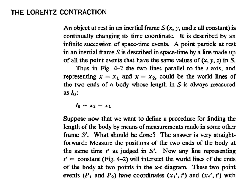

Problem : To measure length of a scale
Rest frame : The frame w.r.t. which scale is at rest
Moving frame : The frame w.r.t. which the scale is moving with speed v along +ve x-axis
In rest frame ,the positions of the two ends of the scale are (measured simultaneously ) x1 and x2. So length L = x2 -x1
and t1 =t2=t
In moving frame,
the positions of the two ends of the scale are (measured simultaneously ) x'1 and x'2. So length L' = x'2 -x'1
and t'1 =t'2=t
Now,
x'2 -x'1 = γ ( x2 -x1 - v(t2 - t1) )
⇒ L' = γ L as t2 = t1
and
x2 -x1 = γ ( x'2 -x'1 - v(t'2 - t'1) )
⇒ L= γ L' as t'2 = t'1
What is wrong here?
I am asking this as I often do this mistake.
I think,
What I am doing here is I am measuring (x2 ,x1),and (x'2 ,x'1) simultaneously.
So, I am having four events.
What I should do:
I am supposed to have only two events for measuring the length and these two events should be such that these are simultaneous in the moving frame while non - simultaneous in the rest frame. Let's denote the two events as A and B.
Now, the coordinates of A and B are in rest frame [(t2,x2 ),(t1,x1)] respectively and the coordinates of A and B are in moving frame [(t'2,x'2),(t'1,x'1)] respectively and t'1 =t'2

Pushoam said:
What is wrong here?
I think that the main problem is that you are thinking of the ends of the rod as two events, but they are two worldlines. So you should be thinking of transforming the worldlines rather than transforming events.

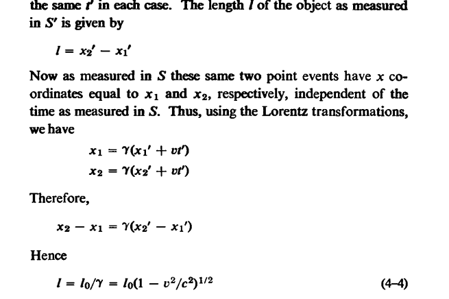

The book is considering only two events.
How to apply the concept of three events?

This is the error x'2-x'1 is not L' when t2 = t1. Because then t'2 <> t'1 so the measuring of the end positions in S' is not at the same time and that's not a correct length measurement.
Look at what they were doing when they said "Now as measured in ##S ## these same two point events have ##x## coordinates equal to ##x_1## and ##x_2##, respectively, independent of the time as measured in ##S##." They are taking advantage of the fact that in the rest frame, and only the rest frame, you can skip the "at the same time" constraint.
