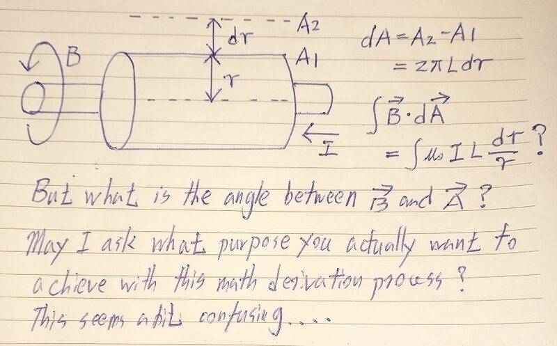

Could you explain further the purpose of the equation derivation?
I feel like there might be something misunderstood or incomprehensible.

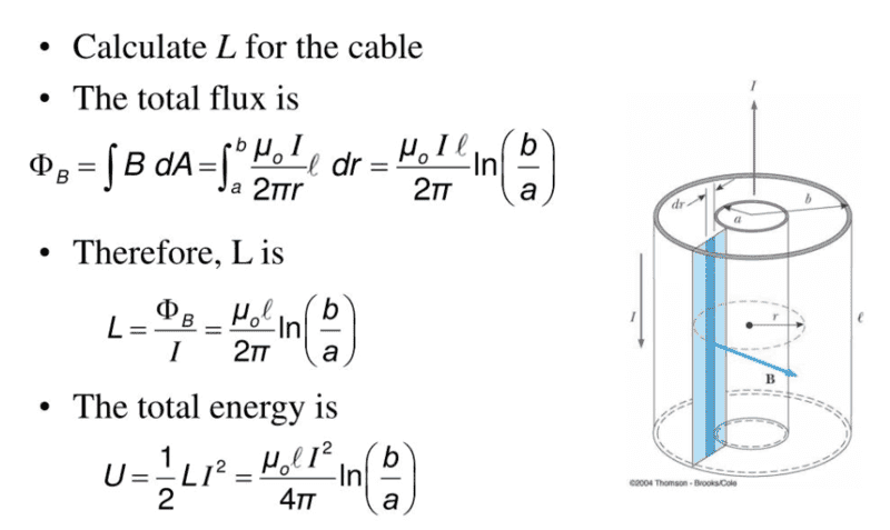

I am trying to get L the inductance and trying to figure out how they derived ##\phi_m## in the image attached. Mostly I don't get how they got dA = LdR

The flux denoted as ##\Phi_B## in that image is not the flux through the lateral surface of the cylinder, but the flux through the blue region. That blue region is not a closed surface so the flux of B can be non zero, no conflict with Gauss's law.
The ##d\vec{A}## of the blue region is ##ldr## (it is the darker blue region of the picture) and points in the same direction as ##\vec{B}##.

The elementary area on a flat plane like the blue surface is ##dxdy##, the area of a rectangle of side ##dx## and ##dy##. So ##\int\mathrm{(something)}dA## in the case of a flat plane is ##\int\int\mathrm{(something)}dxdy##. In this case, though, your plane lies in the r-z plane - i.e. a small radial displacement is ##dr## and a small vertical displacement is ##dz##, so the elementary area is ##dA=drdz##. So the flux through the blue plane is $$\phi_B=\int_{r=a}^b\int_{z=0}^lB(r)drdz$$ (where I've ignored the dot product because ##B## is always normal to the blue plane). But note that the integrand does not depend on ##z##, so you can do the ##z## integral to get$$\phi_B=l\int_a^bB(r)dr$$which is the result in the image.

Why isn't this region all the way around the cylinder of the inner coaxial cable?

We choose this region because it has as boundaries the two conductors of the coaxial cable. From Faraday's law in integral form the EMF in the boundaries (that is in the conductors in this case )due to the time varying B, will be equal to the time derivative of the flux through this region. If we can bring the EMF in a form $$EMF=C\frac{dI}{dt}$$ where C might be functions of many things, except the time t, then C is by definition the desired L. This process is equivalent to bringing the flux in the form ##\Phi=CI## which is what is done in the picture you show.

What I mean is how come the area in ##\phi_m = BA## isn't all the way around the inner cylinder. That is the space between the outer and inner cylinders.
You are confusing surface (measured by area) with volume. The flux is defined through a surface and not in a volume. The space between the two cylinders is not a surface but a volume.
The magnetic field always surrounds the inner cylinder, but you can find the total magnetic flux by simply selecting an area at any angle on the axis. This is because flux is defined through a surface, not volume.
But if you want to know the total energy stored in the magnetic field in space, you need to integrate over the volume.

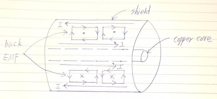

I mean according to Faraday's law, the back EMF created by the magnetic flux impedes the original current flow in the copper core and shield, which is what causes the inductance of the coaxial cable.

You just can't take as surface the lateral surface of any cylinder with axis the axis of the cable. That is because such a surface doesn't have as boundary the inner and outer conductor, so if you calculate the flux and EMF through such a surface (which EMF would be zero for such a surface), is isn't the EMF generated in the conductors.
P.S I am not sure if we can define the boundary of the lateral surface of a cylinder. Not it isn't the outer or the inner conductor of the cable, as you probably might thinking.
