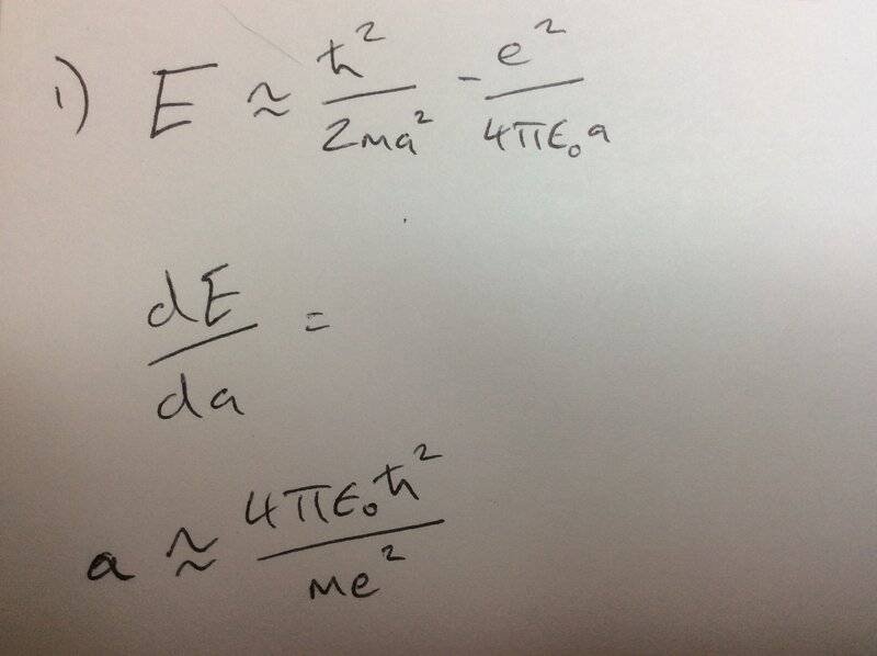

Given an expression for the energy of a particle’s energy in a Coulomb well, how to take the derivative (then set zero, then solve)
I’d appreciate some help with a mathematical block that I’m sure is trivial to most of you.
Given the expression (1):
Take the derivative of E with respect to a, set to zero and solve for a. Answer is shown at the bottom.
This is not homework; I’m following an account of the development of quantum physics. I’m out of practice with my calculus.
Now, I can see an a^2 term that should differentiate to 2a, and another a that should go to 1, but several attempts have not led to the answer. Would someone mind taking me through it?
Posting equations in images is not allowed. Please post your equations using the PF LaTeX feature. You will find a "LaTeX Guide" link at the bottom left of the post window.
You don't have a ##a^2## term, you have an ##a^{-2}## term that differentiates to ##-2a^{-3}##, and similarly you have an ##a^{-1}## not an ##a##. Get this right and the algebra will come home for you.
## E \approx \frac {\hbar^2} {2ma^2} - \frac {e^2} {4\pi\varepsilon_0 a} ## Original equation
## \frac {dE} {da} = \frac {\hbar^2 (-2a^-3)} {2m} - \frac {e^2 (-a^-2)} {4\pi\varepsilon_0} = 0 ## Take derivative and set to zero
## \frac {\hbar^2 (-2a^-3)} {2m} = \frac {e^2 (-a^-2)} {4\pi\varepsilon_0} ## Now (try to) solve for a
## \frac {\hbar^2 4\pi\varepsilon_0} {2me^2} = \frac {-a^-2} {-2a^-3} ## Is as far as my feeble math(s) (last used 24 years ago) will get me.
