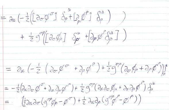

Show that the Lagrangian density:
[tex]L=- 1/2 [\partial_\alpha \phi_\beta ][\partial^\alpha \phi^\beta ]+1/2 [\partial_\alpha \phi^\alpha ][\partial_\beta \phi^\beta ]+1/2 \mu^2 \phi_\alpha \phi^\alpha[/tex]
for the real vector field [tex]\phi^\alpha (x)[/tex] leads to the field equations:
[tex][g_\alpha\beta (\square +\mu^2)-\partial_\alpha \partial_\beta]\phi^\beta=0[/tex]
[tex]\partial L/\partial\phi-\partial_\alpha (\partial L/\partial\phi_{,\alpha})=0[/tex]
We've only just started learning a little bit about tensors, and I am finding questions like this quite difficult. In the lectures we have not covered cases when the field is also a tensor. I know about raising and lowering indices using the metric tensor, and combining ∂s with kronecker delta. Here is what I have tried so far. I have changed some of the indices to avoid problems (Did this need to be done?)...
I've also done a bit that I typed up a while ago, but I started changing some of it and now that I look at it, it doesn't really make any sense, but I think I have the first term of the Euler-Lagrange equation working. I'm not sure if it's quite right, but it begins and ends with the right expression, so it's at least partly right. However, the bit in the image I've uploaded does not lead me to the right answer, so this is where I really need help. Hopefully someone can give me some pointers. Thanks :)

Balllzac - yeah I was just checking on a few things.
My indices may be a bit confused - as it's still early morning for me and I don't have my head in it. I'll give this a reread in about ten minutes and do corrections.
And yeah I think I've messed up the indices on the LHS of the final equation. Tried to make too many jumps ahead in one go.
So clearly I was wasting my time introducing deltas. Is there also no need to change indices? In one of the worked examples from the lecture notes "dummy indices" are introduced. Although I sort of follow what you've done for the first term (which is pretty much how I did it), I'm not sure I fully understand the rules. Obviously it is equivalent to
[tex]d/dx 1/2 x^2 = x[/tex]
but, for instance, is there a particular reason that you end up with a covariant index rather than contravariant? These are the sorts of things that I'm having trouble with, particularly since in the lectures there was no mention of greek indices on the field.
The second term is confusing me. Is there an extra step after the first = that would help explain how you got that? (oh, I just read the edited version of you post, so my last comment becomes kind of superfluous.)
Thanks for all the help Samr :)
Yeah I missed out on the steps inbetween the second E-L term and what it equals in your example Lagrangian density. I'll fill in these gaps later today if that's okay with you :)

Okay, I'm still having trouble getting this bit...
[tex] -\partial_\alpha\partial_\alpha\phi_\beta =-g_{\alpha\beta}\square\phi^\beta[/tex]
I don't understand how the indices change. For example, how does the index on phi remain beta, but change from covariant to contravariant?
Since you're just looking at the term on its own and there is no implied sum it is effectively a dummy variable. [itex]\partial_\alpha\phi^\beta=\partial_\gamma\phi^\rho=\dots[/itex]
Ah sorry I misunderstood what you were asking give me a few minutes.
MY LHS is wrong.
hmmm, okay that makes sense. But now that you mention the summation...There is no summation on the left hand side, yes? Because the repeated index is covariant in both occurances. But then on the right hand side there is a summation within the D'alembert operator. This also has me confused.
Looking at the first term in the lagrangian density - does it help to think about the implied sum between the two partial derivatives, and the fact that since [itex]x_\mu x^\mu=x^\mu x_\mu[/itex] subbing [itex]x_\mu\rightarrow\partial_\mu[/itex]? This may help clear the problem up.
In reference to your post my LHS is wrong :) it's my fault for skipping steps.
It is worthwhile returning to kronecker deltas and metrics when in doubt. The offending term is
[tex]L_1 = -\frac{1}{2}\partial_a\phi_b\partial^a\phi^b = -\frac{1}{2}g^{a m}g^{b n}\partial_a\phi_b\partial_m\phi_n[/tex]
In contravariant notation,
[tex]\frac{\partial L_1}{\partial \phi_{i,j}} = -\frac{1}{2}g^{a m}g^{b n}(\delta^{j}_{a}\delta^{i}_{b}\partial_m\phi_n + \delta^{j}_{m}\delta^{i}_{n}\partial_a\phi_b) = -\frac{1}{2}(\delta^{j}_{a}\delta^{i}_{b}\partial^a\phi^b + \delta^{j}_{m}\delta^{i}_{n}\partial^m\phi^n) = -\frac{1}{2}(\partial^j\phi^i + \partial^j\phi^i) = -\partial^j\phi^i[/tex]
If you recognize that a,b,m,n are all dummy indices, you could skip the second last and third last steps.
[tex]\partial_j \frac{\partial L_1}{\partial \phi_{i,j}} =-\partial_j\partial^j\phi^ i= -\square^2 \phi^i[/tex]
If we worked in covariant notation,
[tex]\partial^j \frac{\partial L_1}{\partial \phi^{i,j}} =-\partial^j\partial_j\phi_i = -\square^2 \phi_i = - g_{ia}\square^2\phi^a[/tex]
One quick method to check your answers is by counting indices.
If we treat:
1) a contravariant index as +1
2) a convariant index as -1
3) 1 / (a contravatiant index) as -1
4) 1 / (a covariant index) as +1
Counting indices for the various equations, we have for:
1) L = 0 (as expected because it is a Lorentz invariant.)
2) [tex]\square^2 \phi^i[/tex] = 1
3) [tex]g_{ia}\square^2\phi^a[/tex] = -2 + 1 = -1
4) [tex]\frac{\partial L_1}{\partial \phi_{i,j}}[/tex] = 0 + 2 = 2
5) [tex]\frac{\partial L_1}{\partial \phi^{i,j}}[/tex] = 0 - 2 = -2
6) [tex]\partial_j \frac{\partial L_1}{\partial \phi_{i,j}}[/tex] = -1 + 2 = 1
7) [tex]\partial^j \frac{\partial L_1}{\partial \phi^{i,j}}[/tex] = 1 - 2 = -1
Note that counting for [(2) and (6)], and [(3) and (7)] give the same answer, which is what we would expect for the LHS tensor and RHS tensor to have the same number of contravariant and covariant indices.
