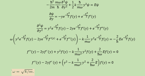

georg gill
151

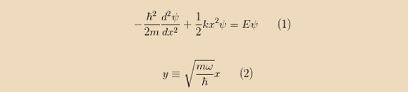

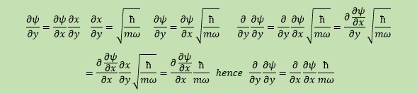

I am trying to obtain the hermite polynomial from the schrødinger equation for a har monic oscillator. My attempt is shown below. Thank you! The derivation is based on this site:
http://www.physicspages.com/2011/02/08/harmonic-oscillator-series-solution/
however the book says:
Seems like your mistake lies in your calculation of ##\frac{\partial^2 \psi}{\partial y^2}##. I suggest that you check again on this point to see whether you had left out one term.
thanks!
