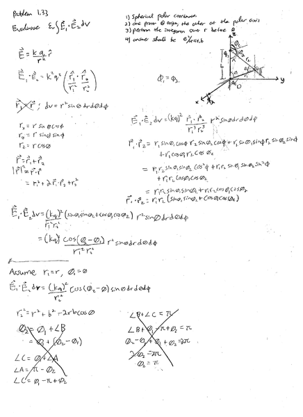

2. Homework Equations
I uploaded my attempt. I started by applying Coulomb's Law for Electric Fields to both protons. I broke down r1 and r2 into their Cartesian components to perform the dot product between the two. Since the two charges were both on the Polar Axis (I think I chose the right axis), I set φ1=φ2. I assumed that r1=r and θ1=θ. I eventually got an expression involving r22 and Cos[θ2-θ]. I was able to rewrite r22 using the law of cosines. I have no idea how to address θ2. I figured that I could use the law of sines to figure it out but the expression turns out to be really messy. I'm not really sure if I'm on the right track or if I've made an error anywhere.
Any advice regarding my mistakes and/or pointing me in the right direction would be much appreciated! Thanks.

Notice that your ##\theta_2 - \theta_1## is just the angle ##\beta## between the two position vectors. You could have gotten your final expression for ##\mathbf r_2 \cdot \mathbf r_1## more easily by thinking of the dot product in terms of the angle between the vectors.
Your idea of proceeding with the law of cosines and the law of sines sounds good to me.
##\cos \beta## will simplify fairly nicely in terms of ##\theta##, ##r_1## and ##r_2##.

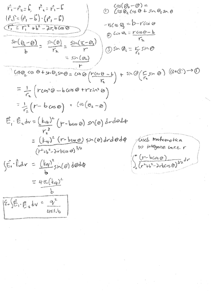

I finally got it. I don't think I did it elegantly because I had to use Mathematica to help me solve an integral. Regardless, thanks for your help, TSny!
OK. Good. To do the r integration, you can do a substitution letting u be the expression inside the ( ... )3/2 in the denominator.
Wow. That makes it such a trivial integral to solve - I can't help but to laugh. Thanks again!
