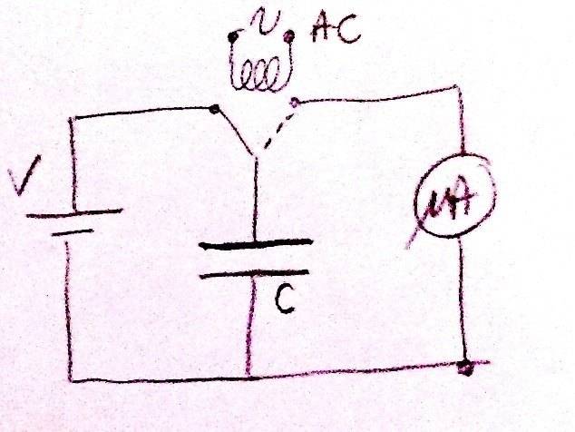

the technique I know uses a vibrating (reed) switch run from a fixed frequency supply to charge and discharge a capacitor. The current measured can be used to find the charge on the capacitor.

This is the circuit arrangement. The voltage of the battery is known. The reed switch is operated by , maybe 100Hz AC. The reed switch alternately charges the capacitor from the battery and discharges the capacitor through a micro ammeter. The microammeter gives the average current flowing from the capacitor..i.e the charge per second from which the charge can be determined.
For accuracy the time constant of the discharge circuit must be much less than the time period of the AC driving the reed switch.

Why is the reed switch NOT in the circuit?

The purpose of the switch is only to connect the battery to the capacitor then the capacitor to the microammeter. It is not part of the "circuit"
details of the technique:
Voltage...this is no problem, it is the battery voltage. Let's say 9V
As an example, if you have a reed switch vibrating at 100Hz and measure a steady current of 100microAmps then 1 micro coulomb is transferred each second.
If you ignore time constant considerations this means that 9V charges a capacitor with 1 microCoulomb of charge
So the capacitance must be C=Q/V = (1x10^-6)/9 = 1.1x10^-7F
You can manipulate these figures to find any of the unknown quantities.
These days reed switches are readily available and this is an easy experiment to do.
If you need any more help with this technique let me know.
PS a signal generator is needed to drive the reed switch at a known frequency
