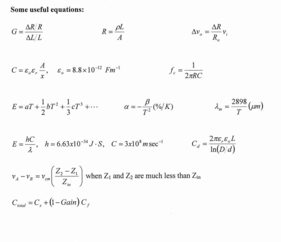

Design a system to measure the electroretinogram (ERG). Use a differential amplifier to maximize the CMRR, and condition the signal appropriately for a 16-bit A/D system with input range ±10 Volts. Give all component values.
Suggest an appropriate sampling rate, assuming that all noise has been sufficiently attenuated by the time the signal reaches the digitizer, and give the resolution of the signal in V/bit at the digitizer.
ERG bandwidth= 0-300 Hz
ERG dynamic range = ± 1 mV
(See attached image)
243239
Welcome to the PF. :smile:
Thanks for posting some of the relevant equations. Now please show us your work on the solution. Also, what do the sensors for an ERG look like, and where are they placed?

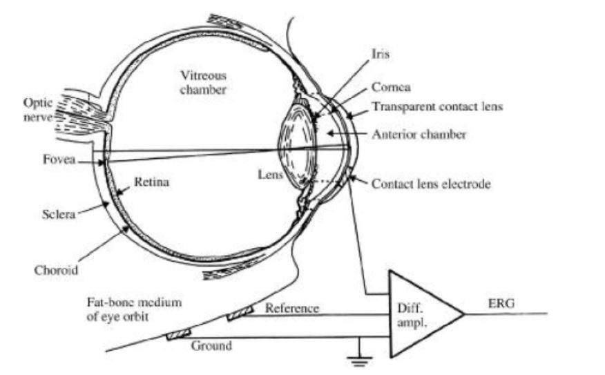

So this is how the actual circuit would be set up 😊
  • Cross-section diagram of the eye showing a contact lens electrode on the cornea, connected to a differential amplifier with a reference electrode and ground, outputting ERG.
Did you draw that, or find it somewhere? A differential amp has two signal inputs, not three.

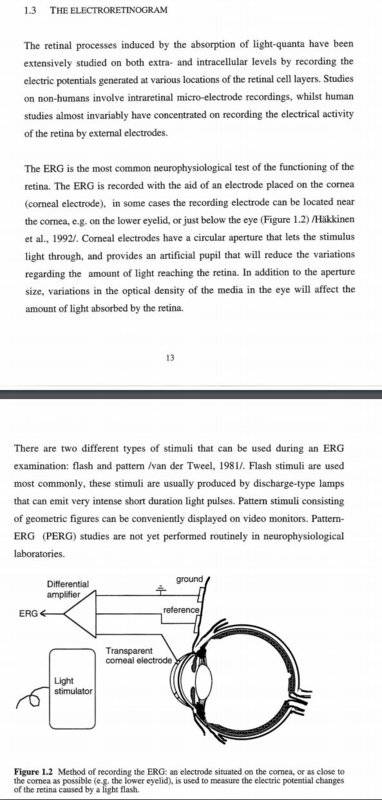

This is a diagram from a textbook - attached is another diagram from another text. that is more or less the same with a ground, reference, and corneal electrode:
  • Textbook page with two paragraphs on the electroretinogram above, then Figure 1.2: block diagram of an ERG recording setup with a light stimulator, differential amplifier, transparent corneal electrode, reference and ground, beside a cross-section of the eye.
Also FYI: in the ERG, the differential amp records the difference between the active electrode (attached to the cornea) and the reference electrode (attached to the outer canthus). The ground electrode is attached to the forehead.
That's not a very accurate or informative diagram, unfortunately. Hopefully you are learning about differential amplifier design for biomedical applications from a better and more detailed textbook or application notes.
So the diff amp inputs should come from closely spaced electrodes at the eye, and the "ground"/reference connection comes from some other large part of the body nearby. The "ground"/reference connection goes into the overall amplifier circuit, not into the diff amp itself.
