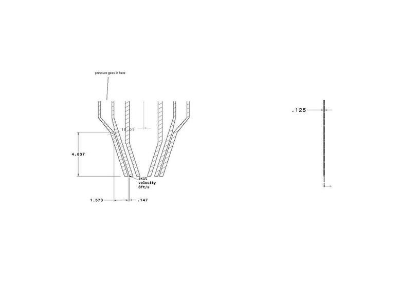

HI,
I'm constructing a 2D nozzle for fluid testing. I have made my nozzle X5 larger and taken a 1/8" slice. Now I'm having trouble designing the 2d nozzle so that the exiting air will have a velocity of 3ft/s. I must maintain an Re number of 1000 as well. My problem lies in that fact that. I can only buy pressure regulators. So what pressure must I use to achieve a exit velocity of 3ft/s
A=.000128 ft^2 (rather small)?
Hi M Pesh,
Can you provide dimensions for your nozzle? Attaching a drawing would help.
I have never loaded a picture into a forum before I hope this worked.
-M.Pesh
You should be able to determine flow rate by making some assumptions on the fluid's (air? water? other?) density at the outlet. For example, if this is venting to atmosphere, and since you want a very low velocity, then outlet pressure would be atmospheric pressure (ie: there will be no significant pressure change at the outlet). So the first step is to determine flow rate required. Note that velocity and Re are dependent on each other, so you may or may not be able to obtain both Re of 1000 AND velocity of 3 ft/s.
Once you know your flow rate, you need to determine a method of controlling this flow rate. Regulators don't control flow rate, they control pressure. However, if you have a controlled pressure, you can then put a restriction downstream of it to control flow rate. If you can provide more detail now as to what fluid you are using and how you intend to control pressure, the next step is to determine how to restrict flow to give you the flow rate you require.

Since you can't measure V directly, and the geometry of this device is a bit too complex to calculate dP accurately for the given flow (and because dP across the nozzle will be so extremely small), I'd suggest measuring flow rate by putting all the gas through a flow meter prior to or right after the nozzle. Rotometers are cheapest option, and should work fine for this application. Get a rotometer rated for air from McMaster Carr or other supplier. Should cost around $30 for an accuracy around 3%. Rotometers are only accurate however, when they're venting to atmosphere. I suspect if you put the rotometer upstream of the nozzle, the pressure on the rotometer outlet will be essentially ambient, so that might work fine, but you'll need to measure downstream pressure in this case to verify it's ambient. Alternatively, you could have the nozzle blow into a chamber (ex: air tight cardboard box) and then have the meter inlet connected to that chamber so you can get a steady state reading of all the air going into/coming out of the chamber.
To vary the flow rate, I'd suggest putting a valve downstream of the reg, set the reg at some pressure, and then adjust the valve till you get the flow you want as measured on the rotometer. This method might be a lot more versatile and reliable than simply trying to set a reg. Pressure will likely be very VERY low with just the reg, so minor flucuations in regulator pressure will cause large fluctuations in flow.
Best solution is to get the pressure up to 25 psig or so, then have a small metering valve that has this (relatively) large dP across it so that minor pressure fluctuations in the reg setting don't significantly alter the flow. If P upstream of the valve is 15 psig or more, the flow will be choked and thus dependent only on the regulator set point and metering valve adjustment. If you set the reg at 25 psig, the metering valve will need a Cv of 0.00097. If you need help finding this valve, just shout.
You got it right there Q. Measuring the flow up stream is the easiest way to go. That's the way we flow test our nozzles and other items. The key is the valve just downstream of the regulator. Once you get that guy choked, you're in business. That way any weird pressure fluctuations due to the nozzle don't make their way back to the regulator. If the OP has a rough idea of the expected flow rates, in stead of a rotometer, they could go with an orifice and just measure the delta P across that to get the flow. However, one trades off the inexpensive option for a slightly more detailed one. It all depends on what they want to do I guess.

Regarding the 5X bigger nozzle, flow is by area, so if area increases by a factor of 5, then flow increases by 5. If linear dimensions increase by 5, area and flow increase by 25.

Because velocity is so low, the pressure drop through this nozzle will be negligable and the air can be treated as an incompressible fluid. You say you don't know the pressure in the nozzle, but the pressure drop to atmosphere is so slight that you can safely assume the pressure upstream of the nozzle is also atmospheric pressure.
Flow rate can then be taken from:
Q = VA
Where Q = volumetric flow rate (cubic feet per second)
V = Velocity (ft/s)
A = Area (ft2)
You have A and V so calculate Q. That's the flow you need to measure with the rotometer. Generally, the rotometer is in SCFM or SCFH, but you're already at standard conditions, so just multiply Q (cubic feet per second) by 60 or 3600 to get SCFM or SCFH respectively. (Ex: For your stated conditions of air at 14.7 psia and 70 F exiting an area of 0.000128 ft^2 with a velocity of 0.6 ft/s I calculate a flow of .27648 SCFH, so you need a rotometer that can measure that flow accurately.)
Note that this is average velocity, not peak velocity. Due to fluid shear forces, the velocity along the walls of the nozzle will be 0 and there will be some maximum velocity farthest from the walls. Between there will be some parabolic velocity distribution.
As for Re, that's simply set by conditions. There's nothing you can do to adjust that. For this case, Re (assuming a circular nozzle) comes out to 47. That's laminar flow as you would expect, but far lower than the 1000 you say you need. Not sure why you say you need an Re of 1000, perhaps you could explain what you're doing with this.
