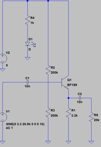

i have added a capacitor before the transistors base but still nothing is my configuration correct? added schematic

Do you have the base and emitter voltages?
You get these by moving the cursor until it becomes a test probe. Then click.
You could try decreasing the size of the top base resistor. Try 50 K.

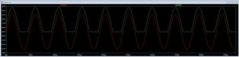

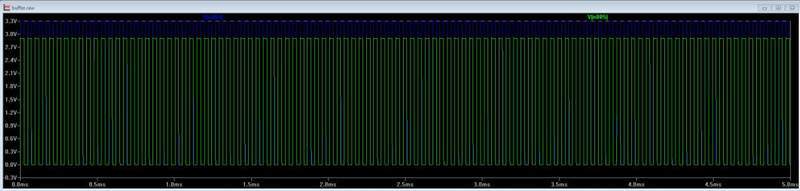

i tried decreasing the size of the top base resistor but it didnt work so i tried changing the capacitor values and now my output looks like this(output is the green colour). so is the buffer working because in your above statement you said
If the output is exactly like the input sinewave, although slightly smaller in amplitude, then the emitter folower is working OK.
since i haven't used a sine wave here but a square wave it seems the output is smaller in amplitude then the original input. is this correct?

You need to use a sine wave, because a square wave output could be the input square wave or it could be the input square wave with the top or bottom clipped off. You couldn't tell.
A sinewave output would indicate that the amplifier is working OK, because any clipping would be obvious.
You seem to be using very large input signals. You should set the input to 0.2 volts so that you will get an input signal of 0.4 volts peak to peak.
However, MEASURE the DC voltages at the base and emitter and post them here.
Incidentally, in the circuit diagram, it shows that the base resistors are not connected to the base. You need to fix this so that there is a blue square where they join like the one at the top of the emitter resistor.
It appears that R2 and R3 are not connected to the base.

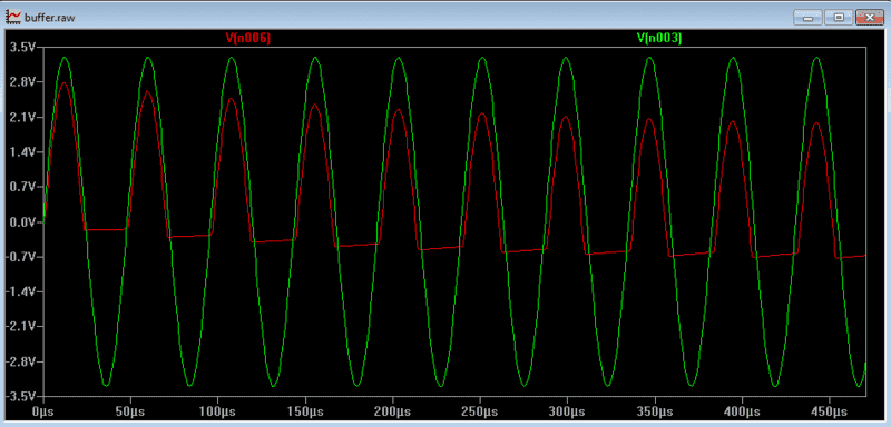

omg i can't believe i did not see that. i have now attached the resistors to the base and this the output i get (red/green graph where input is red and output green):
i wasnt sure to measure the dc voltage using ltspice so i plotted the base voltage against the emitter voltage ( blue/green graph where blue is the base plot and green the emitter plot)

It looks like you are overdriving the amplifier.
Try reducing the signal generator output to a quarter of what it is now.
The output should be a sinewave like the input.
You can measure the DC voltages by reducing the input signal to ZERO and observing the voltages on the graph.
You could also try again to reduce the value of the top base resistor. Try 100 K then 50 K.

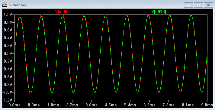

If you click on the voltage generator and get to the "sinewave" description, set the frequency to 1000 Hz, the amplitude to 0.1 volt and the number of cycles to 5000, you can then run the simulation again and see if you get a sinewave out.
new input and output does this seem correct?
Yes, that looks good.
