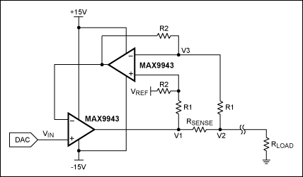

Can someone advice how a V to I converter (with IC741 or any other easily available Op Amps) can be made for converting few mV to pA. The converter is to be used to convert the output from a photo-diode preamplifier to a lock-in amplifier with current input. Thank you for the help, in advance.

So basically what you need to do is have the opamp circuit drop the input voltage across a known resistance, to convert that voltage into a current. And it has to do that non-ground-referenced, so that the current can be made before going into the current input of the amp.
The figure below shows one way to do it using two opamps (ignore the numbers on those opamps in the figure for now):
http://www.maxim-ic.com/images/appnotes/4394/4394Fig03.gif
The feedback opamp on top is sensing the differential voltage across the current sensing resistor, and the input opamp at the lower left is ensuring that the voltage drop across the sense resistor matches (to within some gain factor) the input voltage. That gives you a V-->I conversion, with gain set by the current sensing resistor, and the resistors in the differential gain stage on top.
Are you able to take a first cut at the resistor values on your own? BTW, you should not use a bipolar opamp like the LM741, since the input bias currents and input offset currents are going to be way higher than the pA signal that you want to produce. You should use something like a low-noise FET opamp, like the TL071 or better:

I'll take a cut at the resistor values when I get a chance. Something like converting +10mV to +10pA ?
BTW, it seems like a much simpler (and better?) option would be to use a simple photodiode all by itself (without an internal transimpedance amp), and hook it straight to the current input on the lock-in amp. Connect the [STRIKE]cathode[/STRIKE] anode of the photodiode to the input of the amp, and the [STRIKE]anode [/STRIKE] cathode of the photodiode to the ground of the lock-in amp (assuming that the input is single-ended with respect to ground).
