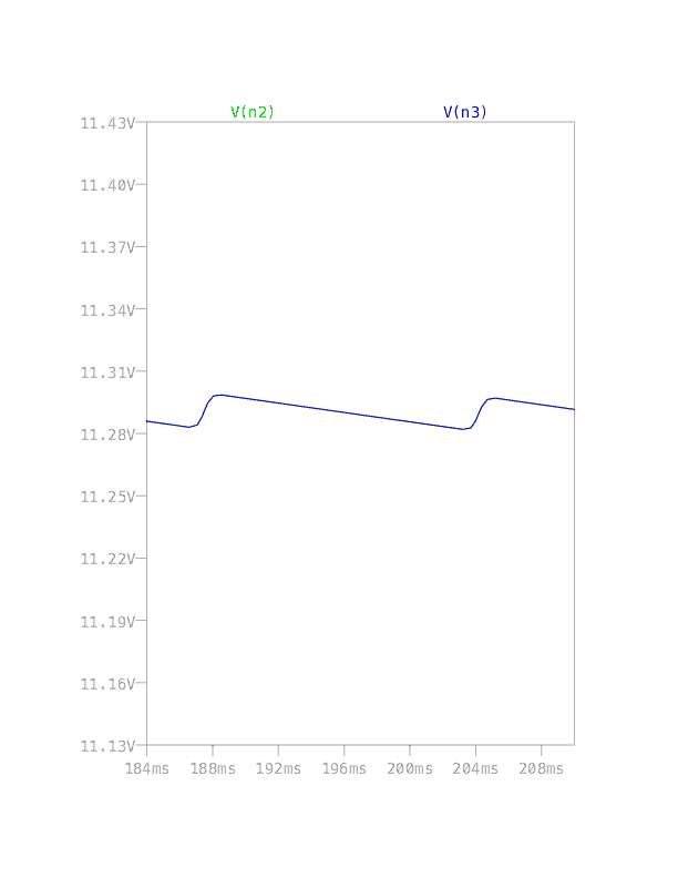

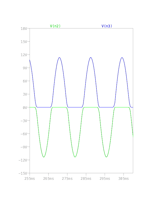

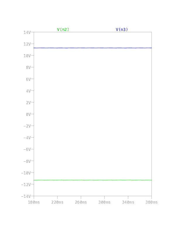

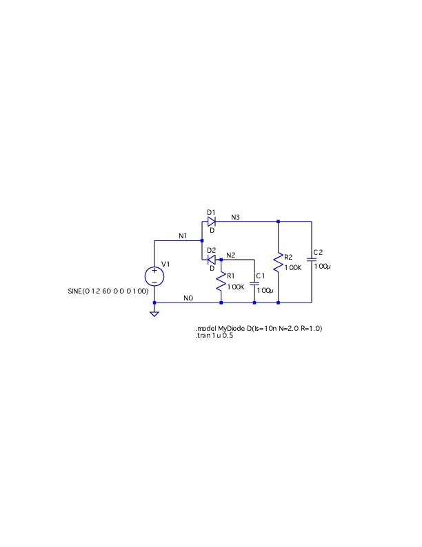

Look at the attached Half-Wave_Circuit.png. D1 conducts on the positive half cycle, and D2 conducts on the negative half cycle. With no capacitors, you will get positive and negative going pulsed DC, as shown in Half-Wave_No_C.png. When you add capacitors, you get +/- 12V DC, as shown in Half-Wave_C.png. Actually, because of the diode drops, you only get +/-11.3V DC, but any circuit will have to deal with this. Half-Wave_Ripple.png shows the ripple that results with the R and C values shown. you can adjust this by sizing the capacitors given the load.
