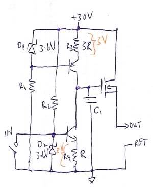

This is a circuit I whipped out quickly and see whether it works for you:
151550[/ATTACH]"]
Hand-drawn schematic of a linear ramp circuit with a +30V rail, PNP and NPN transistor current sources, resistors R1, R2, R3, R4, R, zener diodes D1 and D2 labeled 3.6V, capacitor C1, an N-channel MOSFET output labeled OUT, and input IN and REF terminals.
I have two constant current source by the PNP and NPN. The PNP is always on. The current is about 3V/R3. The NPN is a switchable current source where it is controlled by the switch on the left. When the switch is closed, the NPN is off so the ramp is generated by the current source of the PNP charging C1. When the switch is open, the NPN current source turns on. R3 is 3 times the value of R4, so current by NPN is 3 times the current of PNP. With that, you achieve charging up at a current called I1, but the discharge current is I2-I1=-2I1. You adjust the ramp by adjust the I1 and C1 to get 2 second ramp up and 1 second ramp down.
The N channel enhancement mode MOSFET is the buffer. I use 30V supply to get 24V at the output. I'll let you work out the detail values. Remember the input capacitance of the MOSFET is quite high, so you need to take that into consideration. This is not a precision circuit in any stretch, but it should do what I understand from you post. This is a cheesy circuit, but you are only driving a solenoid! The only formula need is C1V=It as it is constant current and ramp is linear( well roughly).
R1 and R2 is just to bias the zeners on with very low current.
Let me know is that what you want.

@yungman You were quick off the mark with that circuit. :smile: A couple of things as I understand it: his supply is 24V, and the solenoid requires a max drive of 11.2V (1.6A into 7Ω). So possibly include a resistor in the drain of the MOSFET to allow a lower power device.
Oh yeh, anything to lower the power. In fact I am kind of concern with the power dissipation also. I just throw the circuit out as an idea, definitely need some messaging.

That was the schematic, You mean you want the value of the components? Do you understand how the circuit works? I rather you understand the circuit so you can put in the value yourself.
The key is the PNP and NPN transistor setting up as constant current source. You understand the emitter of the NPN is about 0.7V lower from the base ( 0ne diode drop). I use a 3.6V zener to put +3.6V on the base of the NPN, so the emitter is about 3V( don't need to be exact). So you can set up any emitter current by choosing R4. Say if you want Ie=3mA, you put R4=1KΩ. Assume β>100, so collector current Ic≈3mA also.
Same idea as for the PNP where R3=3R4 to get 1mA current from the PNP. So R3=3KΩ.This is just an example, you have to choose your own value and choose C1 to get the ramp time. Remember no need for fancy formula, CV=It is good enough where I is the charging current, t is time, C is capacitance of C1, V is the voltage of the ramp.
R1 and R2 is just to set up the minimum current to bias the zener to operating voltage. Look at the spec of the zener to determine the resistance.
Also include a diode (normally reverse biased) across the coil terminals to protect the electronics against flyback when/if power is accidently disconnected.
If you went with a PWM design (say 2 NE555s and an emitter follower) it would do away with the need to dissipate that unwanted power as heat.
Yes, flyback diode is good. There are so many way to design this, mine is only one of many. Also the Drain resistance to take some power load off the MOSFET.
