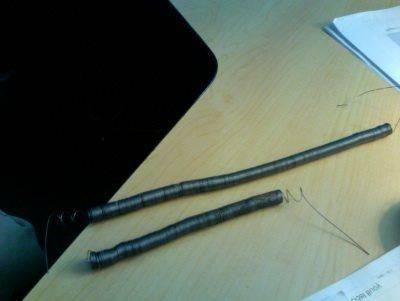

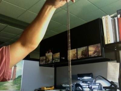

I'm posting two pictures of a spring which is very close to what I need to make. With a 0.1 kg mass, it has 1.1 s period, which is close to the 1.2 s period that I need. I just need to make another that is little longer and I'm there.
This spring was made with about 25 feet of wire with 2 full twists per foot and 10 pounds of line tension. I made this one using a controlled tension, but I really didn't see much better results compared to when I just put a little tension by hand. However, pre-twisting the wire is critical to get nice tightly spaced coils.
It works fine for my application, but I find that it is very difficult to control the pretension over the length of the long coil. The beginning of the coil ends up with a lot of pretension and the end has almost none. However, since I don't need pretension, I was able to slide the spring over a 3/8 inch rod and stretch out the coils with pretension. You can visually see the non-uniformity over the length, but this is just a visual thing that does not affect the overall spring performance. You end up with a spring with low-damping, high natural frequency and an effective spring rate that can be matched to the specification.
One picture is the free spring lying on the table with a centimeter scale ruler in view. The other shows the spring extended while holding the 0.1 kg mass in equilibrium.

Good god that a long spring. I wouldn't want to coil all that wire! Hahah, good job though. :smile:
Thanks for the pics. Maybe you should go into business making hand wound springs! :smile:

Now I can't resist showing a picture of his big brother. :smile: He has a period of 1.6 s when attached to a 0.1 kg mass.
This next spring came out a little better and I didn't use the 10 pound constant tension this time. I also used less pre-twist (1 twist per foot), which seems to be about right. I figured that if I made an extra long spring, I could cut out the section that looks best.
However, once again, there was pretension in the first part of the spring, and almost none at the end of the spring. Does anyone know the physical explanation for this effect? I figured a pre-twist would distribute itself evenly over the whole length, but it seems that the beginning of the coiling process wants to take up more of the existing pre-twist. I'm wondering if this is expected, or maybe I have to look and see if a step in my process is inducing this effect.
