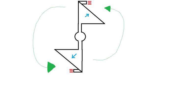

I've been throwing around designs for a space station with artificial gravity for a while now and here is where its at in my head, the drawing is EXTREMELY crude but hopefully someone can understand the idea. the 2d drawing is meant to show a basic side view of it, the blue arrows indicating the gravity. the green showing which direction the craft would be spinning.
the idea is that the centrifugal force from the spinning pushes you down and the inertia in the opposite direction of the spin, so the gravity should be between those two forces, at 45 degrees.
this is almost definitely wrong but could someone please explain if this would work and if not, why? thank you! :)

The artificial gravity due to inertia would come into play only if the station kept accelerating its rotation. I'm pretty sure you don't want to do that, as it would result in constantly increasing "gravity" due to the centrifugal force. Eventually it would crush the inhabitants and tear the station apart.
What you want, is a station rotating at a constant angular velocity. The only moment when "gravity" due to inertia would come into play is when the station is spun up to the desired velocity when constructed. Afterwards, it's only the centrifugal part that would generate artificial gravity, so you want the floors perpendicular to the axis of rotation. This means the station should be shaped like a ring(or cylinder), or sections of it.

of course! I didn't think of that! thank you! so if a donut shaped station was rotating at the right speed, people would be pulled towards the outer edge of it? and there would be no gravity in the middle?? Thank you by the way!
ProdiG said:
so if a donut shaped station was rotating at the right speed, people would be pulled towards the outer edge of it? and there would be no gravity in the middle??!
Yeah, that's about right.
