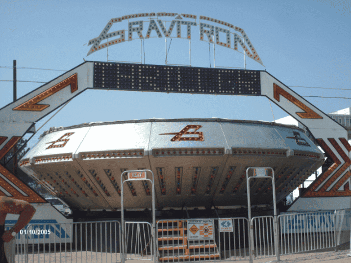

You can study this yourself by riding the Gravitron. Just sit up and move your head around.
And Wikipedia: https://en.wikipedia.org/wiki/Gravitron. I know for a fact that Coriolis effects forced me to lay down on the grass for an hour after one ride, while my then 12 year old daughter rode it continuously for hours. Google motion sickness centrifuge for lots of good information.
I can feel quite nauseous enough after a few rotations of the little roundabout in my granddaughter's local kiddies' playground. I think it's the mucus in my 'tubes'. I definitely no longer have the 'right stuff'. Also, when tacking on my sailboat, Coriolis used to spoil my sense of direction as I tried to change sides in the cockpit and found I was moving diagonally.
The Gravitron is a fixture from my county fair childhood- just the thought experiment of moving around in there makes me queasy. I never had the right stuff. I remember hurling from it, though thankfully not inside the gravitron itself- my lunch came up on the cool down lap on the pirate ship!
