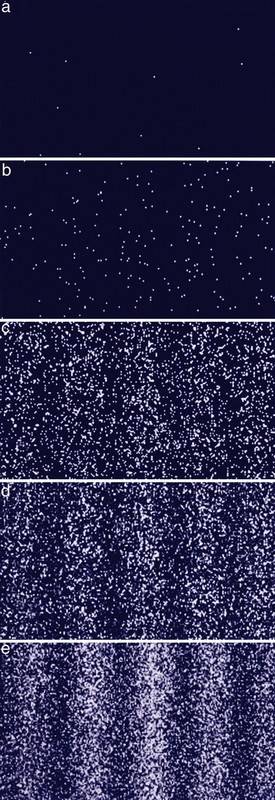

Unless you are doing something analogous to an interferometer experiment, you DO need to know the spatial location of where the electron lands. That's why you can get interference pattern! Otherwise, all the electrons will land at the same location, and how can you tell each one was the result of an interference between the paths?

You don't seem to have taken this problem on board. There is no such thing as the interference pattern of a single electron. When it lands, it lands somewhere and the 'pattern' it makes on a sensor / film is just a single spot. The interference pattern is only there when there are enough electrons arriving to form a spatial distribution with the familiar fringes.
There is no point in replying with the same question, yet again because the answer will be the same and not, I think, what you (think you) want. If you enough time to wait, you could fire billions ( one electron at a time) and that could form an interference pattern.

What you want to do is something like this:
This was why I stated that you not only need to detect the presence of an electron, but also the SPATIAL location of where the electron hit the detector!
Zz.

. . . . and the spatial resolution of the detector will dictate the Energy (hence the wavelength) of the electron beam that must be used. The fringes must be a sensible fraction of the width of the detector and also a useful multiple of the spacing of the elements of the detector. The OP has not come up with this information yet.
