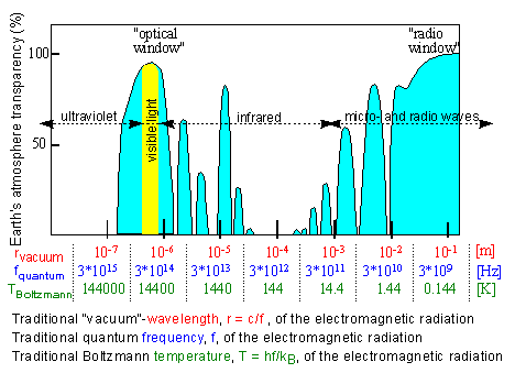

I am sure this will become a 'face-palm' moment, but can anyone point me in the direction of what electromagnetic energy wavelengths on either side of the visible spectrum, that is detectable on earth, ie what is not filtered by our atmosphere? I am specifically trying to find information on the wavelength spectrum of infrared light that hits the Earth's surface.
Thanks.

A quick Google will give you info on this. About 50% of light that reaches the Earth's surface is infra red according to searches. I'm surprised by that, I would have thought longer wavelengths would be more readily absorbed by the atmosphere.

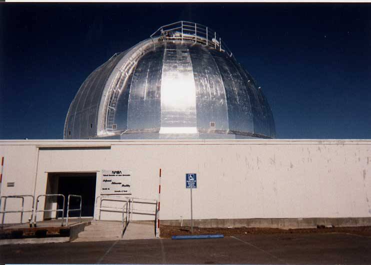

A lot of IR is absorbed by atmospheric moisture. That is why IR telescopes are built on very high mountain tops to get above most of the atmospheric water vapour ... eg. the one on top of Mauna Kea
from my visit there in 1999
The image below, from this site, shows where the Earth's atmosphere is transparent enough for observations. This site has more detail on what component of the Earth's atmosphere is doing the absorption in the IR.
