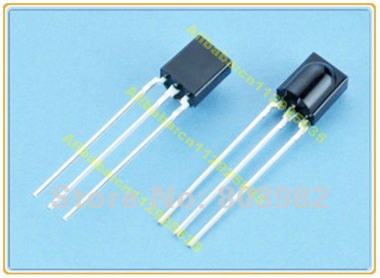

personally, I wouldn't even be considering a HeNe laser or even a laser diode UNLESS the distance between the source and detector was 10's of metres
HeNe lasers are dreadfully power hungry, run hot and have a very short life span ( when run continuously) compared to laser diode or IR LED
For anything up to around 10 - 20 metres, standard IR diodes ( focused) and use an appropriate IR receiver diode.
eg
Factory-wholesale-38Hz-IR-receiver-Module-8-30M-transmission-distance-20mA-2-5-5-5V-plastic.jpg
these have a + and - supply and an output
This will make daytime use so much easier
Dave
