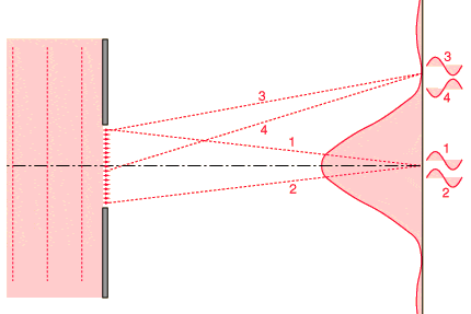

microwave of wavelength 3 are incident to a row of parallel metal rods. The separation of the rods is 10cm. The first order diffraction is observed at 25° to the direction of the incident wave. Determine the angle between the first and the second order of diffraction maxima.
I suppose that the maxima is the strip of bright fringe and this is the diffraction of single strip diffraction. I think that this picture is suitable to describe the problem,
assume that the wave 3 and 4 intersect a point P at a screen and form Bright Fringe(picture shows dark fringe, but i just assume it is bridge fringe, couldn't find a better picture).
First assumption : W4 - W3 = λ...at first maxima
and solving the triangle like how shown in this image
I get θ = mλ/a ...m is 1,2,3...and a is the size of the metal rod separation, 10cm
θ = 1 x 0.03m / 0.1m = 0.3 rad = 17.2°...but the problems say it is 25°but when I assume W4-W3 = 1.5 λ ... for first maxima
i get
θ = 1.5 x 0.03m / 0.1m = .45 rad = 25.78°...closer to the 25° stated in the question
Now my main confusion is W4-W3 for the first bright fringe λ or 1.5λ, what i am thinking now is the bright fringe is the superposition of the W4 and W3, W4 is longer than W3 by 1λ, but the question seems telling it is 1.5λ and so do some of the books and site...

Yeah that 25 is degree, it was in the correct symbol at the time i submit the post... The question didn't state how the microwave hit the grating, i think it should be perpendicular, so what do u think, finding the angle θ for the first bright fringe is:
θ = mλ/a...a = the gap between the rod and m is either positive or negative integers
or
θ = (m + 1/2)λ/a
The top picture in the OP is for a single slit, not a grating. That will give the first minimum at (w/2) sin(θ) = λ/2, and the first non-central maximum at w sin(θ) = 1.5 λ. See: http://web.utk.edu/~cnattras/Phys250Fall2012/modules/module%201/diffraction_and_interference.htm .
If it is a grating, d sinθ = kλ is the condition for the maxima. sinθ can be approximated by θ for angles less than 10 degrees or so, so you can not use it here.
If it is normal incidence, the data are inconsistent.

Well, it is said that the light arrives at a row of parallel metal rods, separated by 10 cm. That is a grating.
In case of a single slit of width W, the minima appear where Wsinθ = mλ.

That image is for a single slit. The dots are not grating lines, they're just to illustrate the argument. Likewise, the first image in the OP is for a single slit. The question is a for a grating, which is different.

Yes, that's my point. But the 25 degrees (1.5λ) is consistent with its being a single slit.
You mean the diagram with read waveform? But how do you differentiate it is single slit or grating by looking at the diagram?
After drawing out the diagram on my own, I finally realize how the 1.5 come, thanks very much ^^

The description mentions metal rods. That makes it a grating.
You mean the diagram with red waveform? But how do you differentiate it is single slit or grating by looking at the diagram?
By the fact that it looks exactly like the diagram for a single slit in the link I posted.
