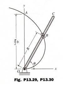

13.30 The colar B slides along a guide rod that has the shape of the spiral R = bθ.
A pin on the collar slides in the slotted arm OC. If the speed of the collar is constant at v0,
determine the angular speed ##\dot θ## of the arm OC in terms of v0, b, and θ.
Diagram of a spiral guide rod R = bθ drawn from point O, with a collar B on the rod, a slotted arm OC through O and B, the angle θ measured from the x-axis, and the label πb/2 on the y-axis.
