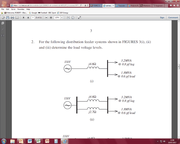

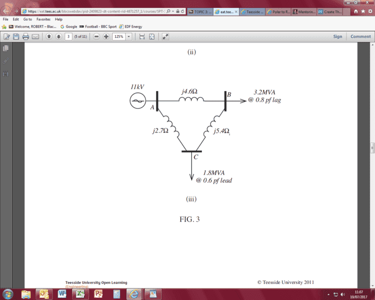

Hi guys, I was just wondering if anybody could help me with the below question
Radial
Total load = 3.2 /_-36.87deg + 2.3 /_ 53.13deg
=(2.56 - j1.92) +(1.38 +j1.84)
= (3.94 -j0.08)
= 3.94 /_-1.16 MVA
Line current (I) = s/sqrt3 * VL
= 3.94 * 10^6/sqrt3*11*10^3
= 207 A
Phase voltage is 6351 volts
therefore 6351 - (4.6 * 207) = 5398.8
so volt drop is 952.2 volts
which is 15% regulation per phase
Does this answer the question for the radial circuit and if so how do I complete the parallel and the ring feeder systems

That's not correct. You are not considering the j4.6 ohm line reactance. Also, you don't know the power angle. Which equations describe the active and reactive power flow between two adjacent nodes?
That is what the lesson information gives when tackling a similar question, ill be honest I am not sure of the equations, that is something I have not covered during the lessons
So the only equation I can think that will help is Q =(Va-Vb)/X Q = (11KV- 3.2MVA)/4.6

You have used the sending end voltage here. It should be the receiving end voltage, which is unknown. The apparent power S that you've calculated is associated with the load, hence you need to use the receiving end voltage in the formula, which you have to calculate in the first place.
You have two unknowns in the equation, receiving end voltage V and power angle δ.
What are the equations for real power P and reactive power Q that contain V and δ?
P = ((Vs * Vr) /X)* sinδ
Q = Vr/X * (Vs*cosδ - Vr)
These would be the equations your referring to I hope. How I work that into the question I've got, I don't know

Yes.
You know P, Q and Vs.
You'll have two equations with two unknowns, Vr and δ.
Solve them simultaneously.

Obviously, you can choose any reference for zero degrees. I just thought it easiest to make the 11KV @ZERO degrees.
But here's another simple way to look at it. With a reactor in series, if the load is reactive then we have a simple voltage divider circuit and the receiving voltage is necessarily <11. But the net load is negative MVAR, a capacitor, so that receiving voltage might be >11.

For the first load i.e. 3.2 MVA, 0.8 pf lag, isn't the load inductive? The current should be lagging, hence, the MVAR should be leading because S=VI*.
So wouldn't it be S=2.56+j1.92?
Or should we take the MVA as lagging, which means the current is leading?
There were two loads, one leading one lagging. It is the sum that counts. The OP had the following, is that correct?

For the second load, 1.8MVA @0.6 pf lead, it should be
1.8*0.6+j1.8*0.8= 1.08+j1.44.
Their sum should be 3.64-j.48.
But what is the significance of that lagging/leading label?
Does @0.8 pf lagging mean the load is inductive or the MVAR is negative (which means the load is capacitive)?
I've always been dyslexic about arbitrary sign conventions, can't remember which is lead and which lag. But one load was lead, the other lag. Only the sum counts. An inductive load draws positive VARs, so if the sum is +VAR, then the receiving voltage is <11, if negative than V>11.

So the sum is negative, means the net load is capacitive, and yes, receiving end voltage is more than 11kV.
