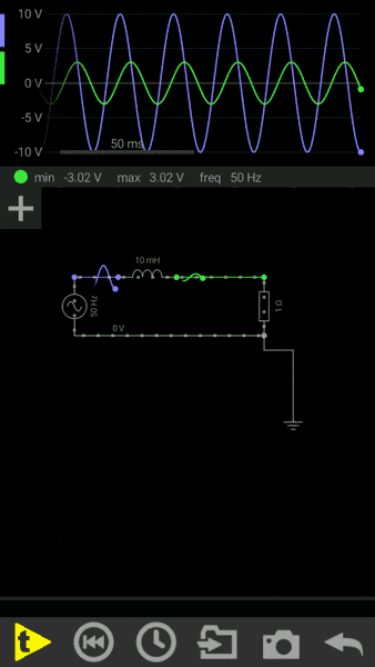

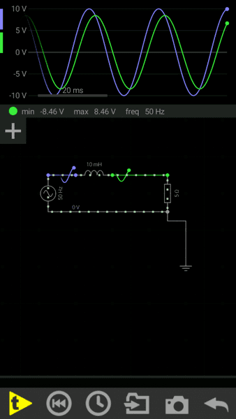

Could you please explain a bit more the proposition that flow of reactive power is proportional to the magnitude of voltage difference between nodes?
Let me see if I understood it correctly.
Suppose a purely resistive load R is fed from an ac supply V through a transmission line with reactance X(negligible resistance). Transmission line reactance X is fixed. Now if load R is increased, more current is drawn from the supply. This causes a voltage drop across X and load voltage is reduced, increasing the difference Vsource-Vload. If the load is decreased, voltage across the load increases and Vsource-Vload decreases, reducing the reactive power flow.

Source voltage is 10V. You can see increase in load angle (by increasing the load) increases the active power (from bottom to top) but reduces the load voltage.
