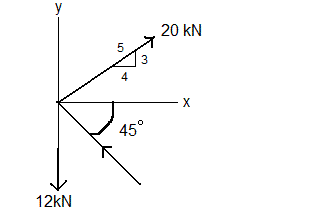

Determine the magnitude of force F so that the resultant FR of the three forces is as small as possible
Need some help??
Thanks,
Nacha
Do you know how to resolve vectors into components? The most direct way to deal with this is to find separately the x-components and y-components for each of the three vectors (calling the magnitude of the unknown vector F for now), then find the sums of the x- and y-components.
You are asked to find the value of F that will make the magnitude of the vector sum smallest. The most direct way to do this requires calculus. Is your course calculus-based?
