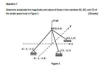

Determine the magnitudes and nature of forces in space truss

equivalent tension coefficient tDE= applied force/distance between points D and E
= 17/SQRT(1[^2+2^2+4^2) = 3.7097
The component of the 17kN in the x-direction = Δx X tDE = -1 X 3.7097
= -3.7097
The component of the 17kN in the y-direction = Δy X tDE = -2 X 3.7097
= -7.4194
The component of the 17kN in the z-direction = Δz X tDE = 4 X 3.7097
= 14.8388
There are three unknown forces, therefore we need three equations.
x -3.7097-3tAD+2tBD+3tDC=0 a)
y -7.4194-tAD+3tBD-2tDC=0 b)
z 14.8388+tAD-tDC=0 c)
I then need to multiply or divide one of these equations to get the unknown values the same so that I can add or divide to get rid of unknown term(s) to solve.
I've tried various options and cannot seem to get to the correct answers.

You seem to be treating the applied force as being along the line DE, but the diagram makes it look as though it is vertical and the text does not mention E. Is there a later part to the question which mentions E?

Firstly there is no mention made of E.
How will I get equivalent tension coefficient without using point E?
Component of 17kN would be down? Therefore -14.8388.
No tBD because the Z co ordinate at B is 0.
Then none of your calculations related to E have any value. Why is it in the picture? Just to confuse, maybe?
