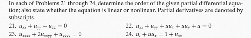

determine the order of the given partial differential equation;also state whether the equation is linear or nonlinear
The ordinary differential equation is said to be linear if F is a linear function of the variables y,y,...,y(n); a similar definition applies to partial differential equations.
The order of a differential equation is the order of the highest derivative that appears in the equation.

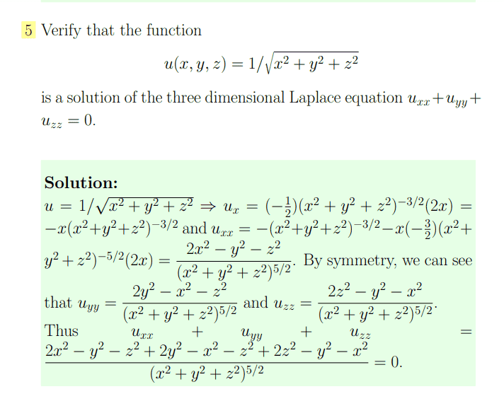

ok I posted this a few years ago but replies said there was multiplication in it so I think its a mater of format

it basically to solve just by observation like 2 order and linear no calculation is needed
In your first post, what do you think the answers are? We can comment on that.

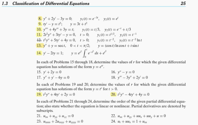

ok I would like that I don't know how to discern linear for non Linear from observation
the yellow highlighted problems are ones I have done but want to do the 15-24
the link to the whole Boyce textbook in the OP if need.
BTW I am retired so just doing this on my own might audit de at UHM next year
Mahalo ahead
A linear differential equation is one where all you have are derivatives being multiplied by functions of the underlying variable and being added together##x^2y'' + \cos(x)y +2=0## is linear.
##\sin(y')=y## is not because you are doing something to a derivative other than adding and multiplying by defined functions of x.
##u_x u_y=0## is not because you are doing something to a derivative other than adding them and multiplying by defined functions of x and y
