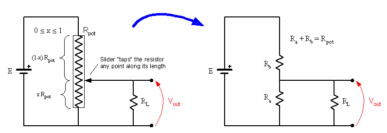

A circuit shows a 10kΩ potentiometer with a 5kΩ load. Determine the position of the pot across point XX (taken across the 5kΩ load) when the voltage across the load is 3v
I DONT HAVE A CLUE...
Really stumped on this one an could do with some explaining this to me in as simpler terms as possible. sorry to sound thick...
I understand we split the 10kΩ resister into 2 so we have 2 5kΩ resisters in series and that we are looking for a ration but that is as far as i seem to understand.
Ive gone through previous posts but seem to get confused with x10k and (1-x)10k.
Please help as i have been on this for weeks and getting peed off with myself for not understanding it.

You haven't stated what voltage is supplying the potentiometer (and there's no circuit diagram attached).
The 10kΩ "pot" is divided into two pieces, but not always 5k + 5k; the potentiometer allows a continuous selection of splits, so long as the total of the two parts is always 10kΩ.
That's why you make one of them be x10kΩ and the other (1-x)10kΩ, letting x range from zero to 1. The two always sum to 10kΩ and x "selects" the sizes of the pieces.

The x and (1-x) are just a convenient mathematical way to specify that the potentiometer resistance is being divided into two parts. It's like taking a plank of length L and cutting into two pieces; If one of the pieces is of length x*L, then what's left must be of length (1-x)*L. The same thing is being done only with the resistance of the potentiometer.
Potentiometers are just voltage dividers, which you should have encountered plenty of examples of. The difference is that potentiometers allow one to manually select the ratio of the resistances comprising the divider. You might find some interesting background material if you do a web search on "potentiometer theory".
Here's a diagram to help you along:

Take a look at the right-hand circuit in the image I posted. Can you write an expression for Vout in terms of E, Ra, Rb, and RL?
My expression for vout would surely be using the correct formula to give me the combined resistance of Ra & Rl but since i don't know the value of Ra how do i go about working it out?
My equation for the Vout would be E*Ra/Rb+Ra=Vout but since we already know this is 3v there must be a way of transposing this? Are my terms of thinking correct or is it back to the drawing board..

You're on the right track. You begin by writing equations describing and relating the things you know with the things that you don't.
I think you already see that E*Ra/Rb+Ra=Vout isn't going to work, since Ra has RL in parallel with it and will so RL will conduct some current too, perturbing the output by some amount (more current will flow through Rb, so more voltage will be dropped across it).
The general voltage divider consists of two resistors. Here the "bottom" resistor is made up of the parallel pair of Ra and RL. What's an expression for the net resistance that this pair represents (maybe call it "Rp" for "R parallel)?
Now write the voltage divider formula using this expression for the bottom resistor value. The top resistor remains the same, Rb.

It's not the same... it has a different resistance, Rp, for which you can write an expression and substitute for it. What's the expression for Rp?
Well the expression for Rp is Ra+Rl which would give me an equation of Vout=E*Ra+Rl/(Rb+Ra+Rl) I think...
Harrison01 said:
Well the expression for Rp is Ra+Rl <snip>
Nope. That's not the expression for two resistors in parallel. That's for two resistors in series... What's the expression for two resistors in parallel?
2 resistors in parallel is Rp=Ra*Rl/Ra+Rl.

Okay, make that substitution for Rp into the voltage divider expression.
When that's done, think about what you know about Ra and Rb and the resistance value of the potentiometer, Rpot.

Okay, as I suspected something's gone amiss with your voltage divider expansion/simplification. Note that terms like (Rb + Ra/Rb) can't exist due to unit issues; Rb has units of Ohms and Ra/Rb has no units. You can't add a unitless number to one with units. You'll have to try the simplification again I'm afraid. There should be pairwise products of resistors in the expression. If you are having trouble, you can always post your simplification steps for review.
Once you have that straightened out, you'll write what you know about Ra, Rb, and their total as an equation. Then you'll have two equations in two unknowns.
Alternatively, make the immediate substitutions Ra = x*R; Rb = (1-x)*R, where R is the resistance of the potentiometer. Solve for x, the portion of the potentiometer that represents resistor Ra.

Presumably that's:
Vout= E* Ra*Rl/[(Rb*Rl)+(Ra*Rl)+(Rb*Ra)]
Square parentheses added to really nail down the order of operations, and that would be correct :biggrin:
Now proceed as indicated (my previous post) to solve for Ra (or directly for x).

Now i must be incredibly here thick but how can i carry out the maths if i don't have figures to put in the places of Ra & Rb. I just don't see how putting X or (1-X) helps. I understand that they are relevant to a ratio but if i don't have number to put in how can i work it out.
So by using the equation i have
9*Ra*5000/[(Rb*Ra)+(Rb*5000)+(Rb*Ra)]
9*x*R*5000/[((1-x)*R*x*R)+((1-x)*R*5000)+((1-x)*R*x*R)]

Okay, now that whole thing is going to equal 3, or Vout, right? And what is the value of R?
Yeah Vout equals 3v and R is 10kohms
So, solve for x.
So I'm thinking x=Vout/10kohms=3/10000=0.0003ma

:confused: What happened to the equation you spent so much time deriving? x should be a unitless number, representing the fraction of the potentiometer that is Ra.
