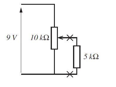

james123
The circuit of FIGURE 2 shows a 10 kΩ potentiometer with a 5 kΩ load. Determine the position of the slider on the ‘pot’ when the voltage across points ‘XX' is 3 V.
I really don't know the right way to start this.
If I'm being honest, I've seen the answer posted elsewhere on this website but I don't just want to copy it, I want to learn it but the way it's explained elsewhere isn't clear to me.
If anyone could provide a starting point/simpler explanation on how to approach this, I'd massively appreciate it

There is no image in your post.
Apologies, this is the image

I understand that the 10kΩ resistor needs to be split into 2 resistors and I understand that it will end with a quadratic.
Just not sure how to begin that's all.
Draw the circuit as 3 resistors, the right one is 5kOhm, the left 2 are R and 10kOhms - R. Then write the voltage divider equation and solve. Please show your work. Thanks.

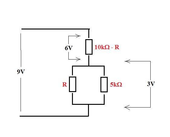

Ok, so I re-drew and instead of the 10kΩ resistor I have the top one 'R', and the bottom one '10kΩ-R'
The used product over sum rule to deal with the bottom resistor and the 5kΩ resistor and got:
10kΩ-R x 5kΩ/10kΩ-R + 5kΩ
= 50kΩ-R/15kΩ-R
= 3.3kΩ-R
Now I'm confused again, do I put put this value into:
with R1 being 'R' and R2 being '3.3kΩ'?
= 50kΩ-R/15kΩ-R
= 3.3kΩ-R
This is not correct, both algebraically and dimensionally.
Try the KCL method.
What is the voltage across R? What is the voltage across 10k-R? What is the current through the 5k resistor?
The voltage across R is 6V
The voltage across 10k-R is 3V?
The voltage across 5k is 3V?
Right.

So,
Current for R is I=6/R
Current for 10k-R is I=3/10k-R
Current for 5k is I=3/5= 0.6A??
james123 said:
So,
Correct.
So what is the KCL equation from this information?

So the current for these two:
10k-R is I=3/10k-R
5k is I=3/5= 0.6A
Is equal to:
R is I=6/R
10k-R is I=3/10k-R
5k is I=3/5= 0.6A
Is equal to:
R is I=6/R
Yes. Solve for R.
