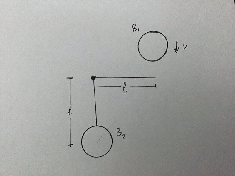

Find the final velocity of B1 and B2 right after collision
E1=E2
In the figure below Ball 2(B2) is hanging and attached to a square lever. B1 drop from gravity and hit the lever as shown. Calculate velocity of B1 and B2 with gravity influence right after collision. The mass of B1 and B2 is identical.
Using energy equation E1=E2, therefore VB2 final = VB1 initial, VB1 final= 0 Right after collision. But this is without gravity. How can I include gravity?

There must have been more information. Were you given the velocity of B1 just before it hits the lever? If not, what?
The velocities immediately after the collision are not affected by gravity. Acceleration takes time to alter velocities.
How do you know energy is conserved?
Please state the whole question exactly as given to you.
This is a problem given by a friend. B1 could be any velocity. During the duration of collision gravity is a net force. Isn’t this net force contribute to the increase in velocity? I can only start with conservation of energy, but it only work if this was in space without gravity.

Sure, but you need to know what variables are allowed in the answer. If the question says the speed of B1 immediately before impact is ##v_1##, say, then you know ##v_1## is allowed in the answer; but if told B1 was dropped from height h then you would use that.
Yes, but how long does the collision last? If not told then you should take it as instantaneous, and since the change in velocity is acceleration x time, acceleration has no effect.

I think we want to see what happens during collision.
I come up with a solution, but it doesn’t make any sense. Gravity force is mg and both masses are stuck together via the lever during collision, therefore the acceleration is halve. So after collision:
VB1= 1/2g x t
VB2= VB1(before collision) + 1/2g x t
This violate conservation of energy since the change in B1 height during collision cannot account for the extra energy.

For finding the velocity immediately after, use conservation of angular momentum instead. Do you see how?
Gravity will still not affect the velocity immediately after, just the acceleration.

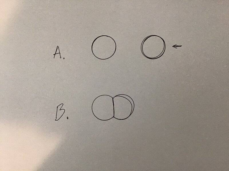

We can take the lever away and replace it with simple collision as shown. Would this be the same?
Yes.
Okay, a net force is applied for the duration of collision, say .3 second. This would simulate gravity. Yes?

Sure. Where is the force applied? How does the force between the balls behave, like a spring?
The force applied in the direction of the moving ball of course. You can say the force between the ball behaves like a spring, but the applied forced only see them as a single object. So after collision
right ball speed= 1/2 a x .3 seconds
left ball speed = v + 1/2 a x .3 seconds

I meant is it applied only to one ball and in the direction towards the other ball? I assume so.
Your equations above need to be justified by an actual mechanism. If the force between them is like a spring then they will not generally have the same acceleration.
If their displacements from where they were at contact are ##x_L, x_R## and the force per unit mass between them is C(t) then
##\ddot x_R=F-C##
##\ddot x_L=C##
##C=k(x_R-x_L)##
This is clearly SHM plus a constant acceleration of the system. The COM will move at speed ##\frac{v+Ft}2##, so the solution is of the form
##x_R=\frac{2vt+Ft^2}4+A\sin(\omega t)##, ##x_L=\frac{2vt+Ft^2}4-A\sin(\omega t)##, where ##\omega^2=2k, A=\frac v{2\omega}##.
