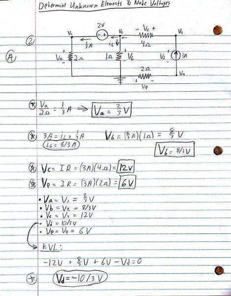

Hello. I am working on this problem and I just wanted someone to check it out if I did it correctly. I was kinda confused about some of the nodes and why we even needed to find voltages at those points because in a lot of cases those nodes seemed to be equal to Va, Vb, Vc, etc... Like node 1 (V1) looks like it's just equal to Va. Same with Vb = V2 and Vc = V3. Is that correct? Also, does the rest of this seem correct?

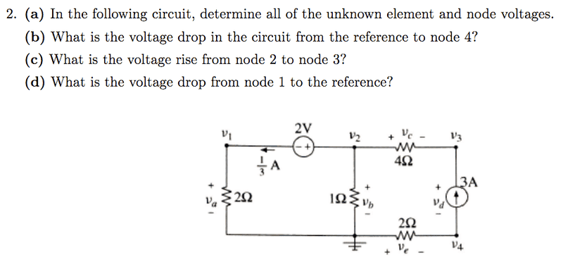

Take a close look at ##v_c## and how it's defined on the circuit diagram. Which way is the current flowing through the 4 Ω resistor?
The current is flowing to the left. I forgot to mention that there was a typo made by the professor in that diagram. The signs should be flipped for Vc. The diagram in the picture of the solution should be correct.
Okay, that makes a difference.
Your work looks okay except for 2(C). They're asking for the voltage rise from node 2 to node 3, and since that direction is against the flow of the current, will the potential increase or decrease?
I think they're just checking your understanding of potential in a circuit with respect to a reference node. The potential at a node may be the same as the potential drop across a component connected to that node if that component has one "leg" connected to the reference node. If there's no such connection then the potential across the component does not define the potential at the node.
Ok that makes more sense now.
