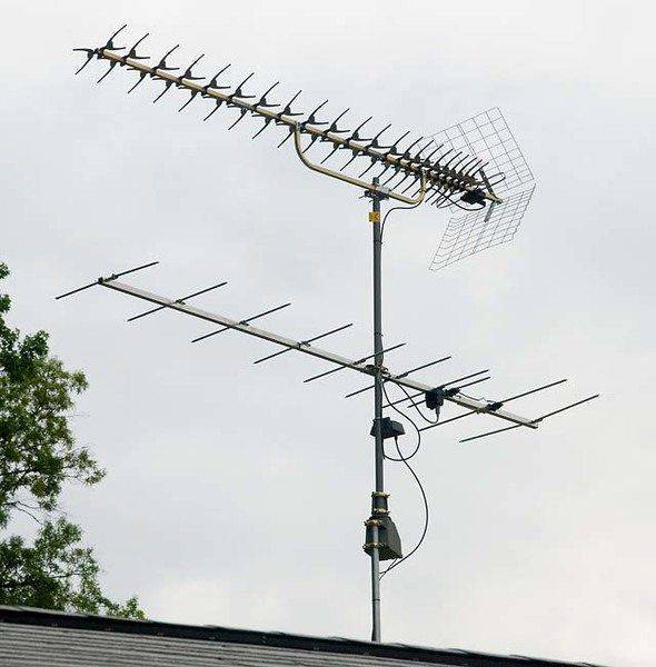

I'm one of those old-fashioned people who still gets broadcast TV via an antenna on my roof. I live in a rural area with TV stations in three different directions, and use a directional antenna with a rotator for optimum reception. When I watch the "signal strength" meter in my TV tuner while rotating the antenna, it's very obvious when the antenna is aimed towards the transmitter, versus directly away from it, or at an angle. In this picture, the transmitter is to the left, about 70 miles away.

Not necessarily. Directional antennas like mine are more sensitive in the "forward" direction than in the "backward" direction. Look at the specifications for good TV or radio antennas, and you'll find a quantity named the "front to back ratio," in decibels.
I updated my post with a picture while you were writing yours. The antennas are asymmetrical, and their "reception pattern" reflects this.
[added] Here's a page with plots showing the reception pattern of the upper antenna, as seen from the top and from the side:
http://www.hdtvprimer.com/ANTENNAS/XG91.html
