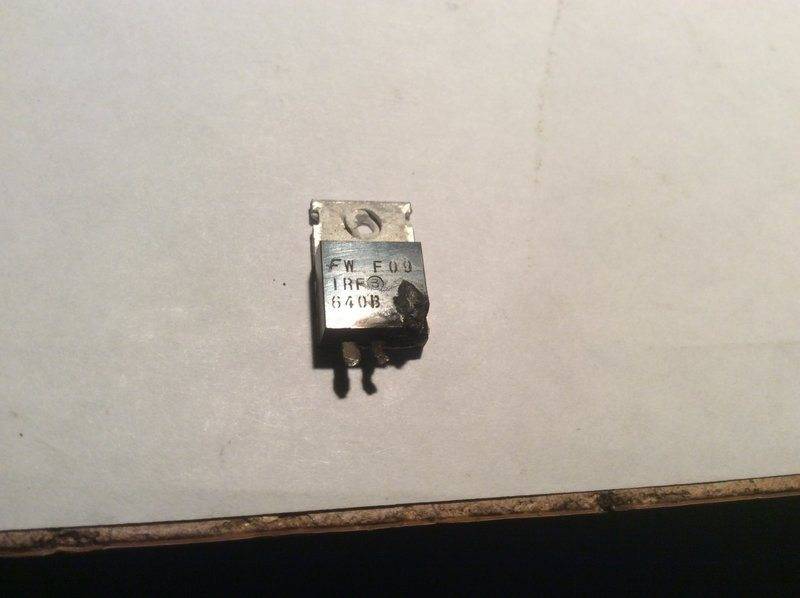

This is the cause of all the trouble. I replaced the whole set with IRF640N.
It's always the output MOSFETs - couldn't you build a more robust inverter with an IGBT or just a much larger MOSFET with proper heat sinking? Isn't a row of piddly little units bolted to the case rather fragile? Seems to be from my experience - most inverters I've repaired (it's an odd hobby) have failed in this way. Some just need new MOSFETs, others have lost some of the drive circuitry.
Another thing - is there a better way to isolate the driver ICs and other semiconductor devices from a rogue short or overvoltage condition? I suppose surface-mount fuses would fatigue, but what about a MOV or two? SCR crowbar? These mass-produced inverters seem to lack provisions to a) stop the MOSFET from failing and b) stop the fault from propagating upstream. In contrast, even a cheap SMPS wall-wart will sit there chirping with the output dead shorted, and manage not to blow itself to bits.

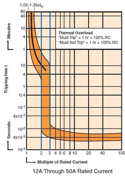

  • #38
Asymptotic said:
Would one of these open quickly enough to protect a MOSFET bridge from a load short or severe overload?
Doesn't look encouraging. The safe operating area (SOA) of the IRF640 peaks around 30A and 10ms. The breaker curve shows a trip time anywhere from 10ms up to 20 seconds for a 30A load. Ouch!

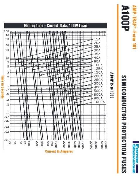

Wow! i never before saw a breaker faster than 10 milliseconds. There's a limit to how fast the mechanical parts can move, and it takes finite time to quench the arc.
Usually one has to protect semiconductors with a current limiting fuse.
Shawmut form 101 Amptrap is an old standby. They're filled with sand to brute force the arc current to zero rather than wait for the next sinewave zero crossing.
I tested 15 amp ones in my plant and found at 10X overload they'd open in usually a millisecond sometimes two, depending on how close to sinewave peak the fault occurred.
http://www.ferrazshawmutsales.com/pdfs/A100P.pdf
i couldn't find a recommended fusing I2T for those mosfets, like they provide for big SCR's.
I remember being surprised as well after finding them in the Altech catalog. Went looking for, but couldn't find an in-depth explanation how they operated, and didn't try any, but I've used plenty of form 101 Amptrap fuses protecting everything from SCR DC drive bridges to resistance heater solid-state contactors.
Just jawing here, but my opinion of fuses versus circuit breakers for semiconductors balances on a razor edge. When a fuse blows, it takes time to get a replacement from stores, lock out the circuit, install the replacement, and re-power the circuit. During that time the semiconductor has cooled significantly, and increases it's chances of survival if the replacement fuse blows. A second fuse failure also prompts the technician to dive deeper into why, if only because there isn't an infinite number of replacements in bench stock.
The same thing that makes a circuit breaker attractive - it's ability to be quickly reset - can also be it's downfall as a protector of semiconductors. It is difficult for a tech to resist the temptation of making multiple reset attempts, the die doesn't have enough time to cool, and usually ends up in a splash of silicon.

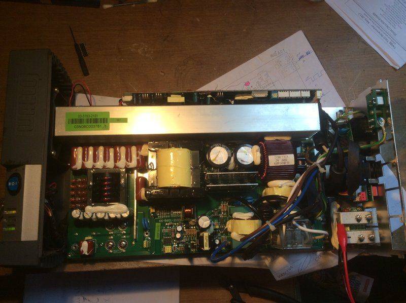

One does indeed learn a lot from troubleshooting. Thankfully, this new inverter doesn't need too much...

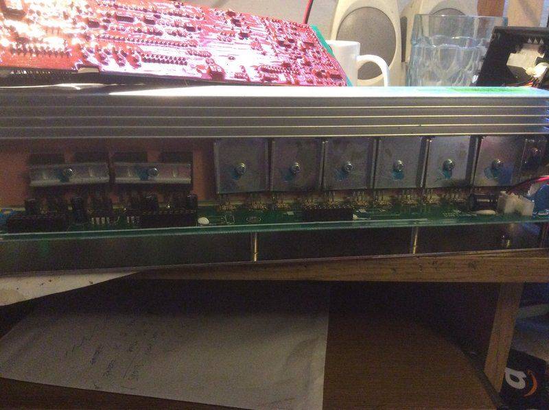

Here's the transistor array. The 12 units on the right receive a 0-12V square wave at 31 kHz. I'm guessing these are the input push-pullers.
Interestingly, the four left-hand transistors receive a gate drive of 0-220V peak in a sinusoidal pattern at 50 Hz. It looks like the sine output is already there before the output is filtered.

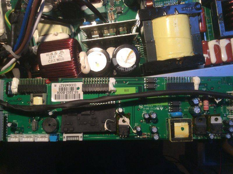

A closer look at that daughter board (bottom) - conformal coated on the back to keep out fiddlers like me! Note clock crystal. There's a microcontroller at work here, shaping the gate drive to the output MOSFETs. Maybe Lancaster magic sine waves?!
The output. Note slight wibbliness at zero crossing point.
