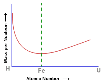

Only when mixed together[edit: sometimes[second edit: actually, always]], to make an atom.
see: mass per nucleon graph.
I'm not very good with words, so a graph is the only way I can understand this phenomena.
