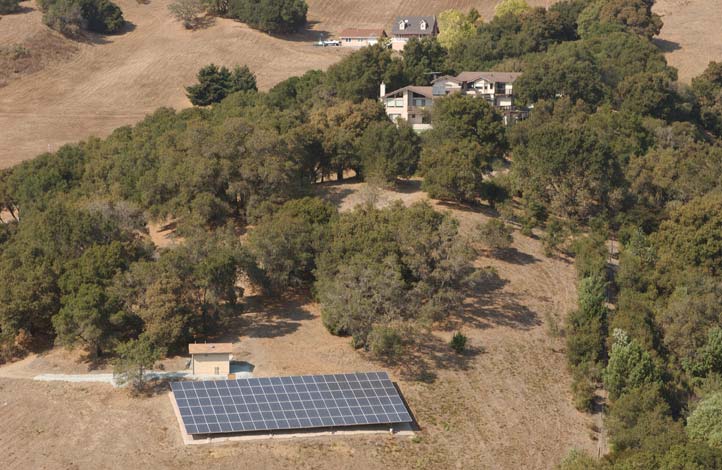

This is not the case. We paid up front and over the life of the panels will *save* around 10,000 dollars (that *would* have gone to SoCal Edison with traditional energy.)
A friend of ours is getting panels with a home equity loan. He will come out ahead the first year (by about a hundred dollars) and come out further and further ahead every year following - and over the life of the panels will save (if I recall) about 5000 dollars.
So at present, the local utility is so expensive as to make solar worth it.
This *may* only be the case in California, where we have lots of sunshine and solar panel rebates.

We got our 2.5 kW system installed in February. It's much more than 10 square feet - I think more like 50 but I'd have to measure it and its outside.
Pengwuino meant square meters when he said square feet. Solar panels are rated by multiplying their efficiency at 20 degrees celsius by a standard solar insolation value of 1000 watts per square meter (the maximum that could be expected at the absolute optimum spot on Earth at the absolute optimum time; solar insolation is at best never more than a fraction of that at any point in the continental United States). 25% efficiency * 1000 w/sqm = 250 w/sqm. 10 square meters of 25% efficient panels gives us 2.5kw.
10 square meters = 108 square feet. Your 2.5kw PV array, Pattylou, probably measures more in the neighborhood of 150 to 200 square feet, since consumer-grade solar panels are much less efficient than 25%.
