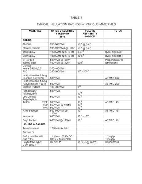

I need a huge table of the dielectric consant and breakdown of various materials...
I have looked all over the net but can only find small tables with 5-10 materials...
Here is a not so huge table I have compiled. Sorry it's not in text format, you will have to
type it into your database.
