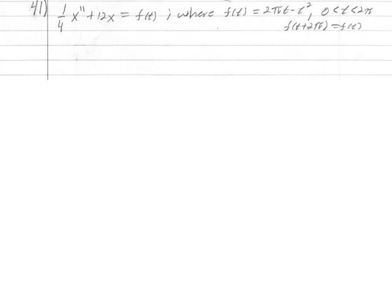

Find the particular solution xp(t) of equation [tex]m\frac{d^{2}x}{dt^{2}}+kx=f(t)[/tex] when [tex]m=\frac{1}{4}[/tex] , k=12, f(t) is given. Assume that when f(t) is extended to the negative t-axis in a periodic manner, the resulting function is even.
So, What does it mean to extend f(t) to the negative t-axis in a periodic manner? And what does it mean when an example in the book says a 2p-periodic extension?
And how do I use [tex]f(t+2\pi)=f(t)[/tex]
Thanks for looking!
You have [itex]f(t)=2\pi t-t^2[/tex] in the interval (0,2pi) and you want to extend it in a periodic even "extension" to the negative t-axis from (-2pi,0). So wouldn't f(-t)=f(t) in (-2pi,0) for it to be even? So what happens if you just take the mirror-image of f(t) across the y-axis? What would that give you? But then that "extension" is not [itex]f(t)=2\pi t-t^2[/itex] right? What is the equation of that curve? Likewise, to extend it to the interval (2pi,4pi) in an even manner so that f(2pi+t)=f(t), wouldn't you just reflect it again across the line y=2pi? What then is the equation of that curve in (2pi,4pi)? Then the periodic even extension is just a continuation of those reflections.<br /> <br /> Not sure though what you want to do with that in regards to the DE.[/itex]

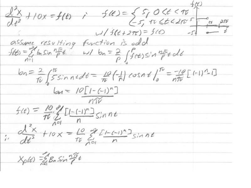

Could someone please let me know if I have done it correctly so far? It said assume the function to be odd when f(t) is extended to the negative t-axis in a periodic manner.
If I'm right up to where I ended, I got stuck when I have to substitute xp(t) into my resulting diff eq. How do I go about doing that?
Also is my graph right? Minus the extension?
Solve the equation x''+10x = sin nt and then use the principle of superposition to write down the solution for the given f(t).

Hey vela, thanks for stopping in. Did I do this right?
So I solved for x''+10x=sin(nt) and got [tex]C_{1}e^{\sqrt{10}t}+C_{2}e^{-\sqrt{10}t}+\frac{1}{10-n^{2}}sin(nt)[/tex]
Considering I did that right, how do I use the principle of superposition?
You don't need the homogeneous part of the solution. You can tack that on at the very end if needed.
Suppose x''+10x = f(t) has solution x1(t), and x''+10x = g(t) has solution x2(t). Using the principle of superposition, you know the solution to x''+10x = f(t)+g(t) is just x(t) = x1(t)+x2(t).

I guess I'm just confused about what I'm doing now. I thought I was substituting xp(t) into the equation above it (the last picture I posted, at the bottom).
frozenguy said:
But in this case it isn't a sum of terms, its just f(t), a piecewise function yeah?
The first part of the problem was express f(t) as a Fourier series, which is a sum.
Oh, sorry, I missed what you wrote earlier. You can also solve the problem that way. Just plug the series into the differential equation:
[tex]\frac{d^2}{dx^2}\left(\sum_{n=1}^\infty B_n \sin nt\right) + 10\left(\sum_{n=1}^\infty B_n \sin nt\right) = \frac{10}{\pi} \sum_{n=1}^\infty \frac{1-(-1)^n}{n}\sin nt[/tex]
Differentiate the series twice, term by term, and then collect terms. The coefficient of sin nt on the lefthand side has to match up with the coefficient of sin nt on the righthand side, allowing you to solve for Bn.

So if this is right, I'm not completely sure how to add these. I know how to add power series, but I don't think these are power series..
[tex]\sum^{\infty}_{n=3}\left((-n^{2})B_{n}sin(nt)\right)+10\sum^{\infty}_{n=1}\left(B_{n}sin(nt)\right)=\frac{10}{\pi}\sum^{\infty}_{n=1}\left(\frac{1-(-1)^{n}}{n}sin(nt)\right)[/tex]
Why did you change the first summation from n=1 to n=3? The n=1 and n=2 terms don't drop out when you differentiate them twice.
I went back to power series to double check how to differentiate them and I don't think I can do that here. Or I did that wrong too haha.
So when differentiating that first series twice, it should be what I wrote but starting at n=1
And these don't look like like they will match up to the right side..
Now write the LHS has one summation.
[tex]\sum^{\infty}_{n=1}\left(B_{n} (10-n^{2}) sin(nt)\right)[/tex]
But I don't see how this can match the other side.
