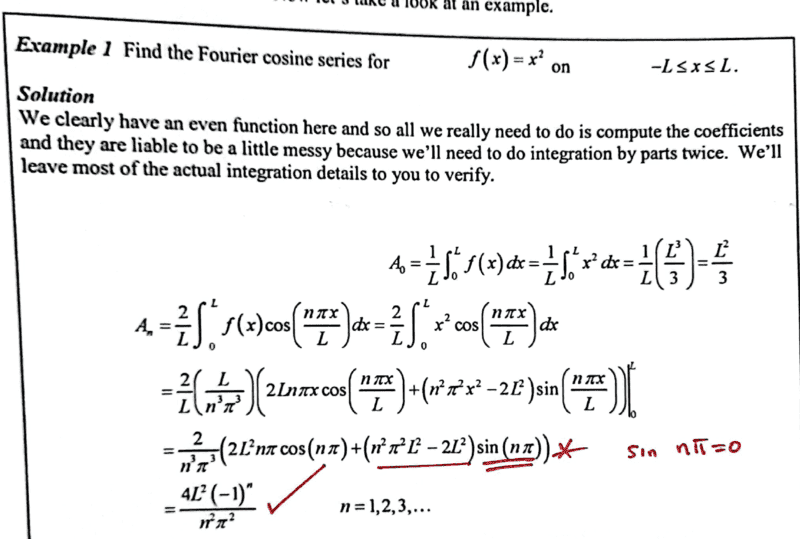

Kindly see attached (just need clarification on highlighted part).
Fourier cosine series
Printed worked example of a Fourier cosine series for f(x) = x^2 on -L to L, with coefficient integrals A0 and An, and a red-marked line where sin(n pi) = 0 is noted.
My question is; is showing the highlighted step necessary? given the fact that ##\sin (nπ)=0##? My question is in general i.e when solving such questions do i have to bother with showing the highlighted part...

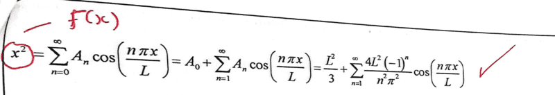

secondly,
Handwritten Fourier cosine series: f(x) annotated above x^2 = sum from n=0 to infinity of A_n cos(n pi x / L) = A_0 + sum from n=1 to infinity of A_n cos(n pi x / L) = L^2/3 + sum from n=1 to infinity of 4L^2(-1)^n/(n^2 pi^2) cos(n pi x / L).
Can i have ##f(x)## in place of ##x^2##? Generally, on problems to do with Fourier series- what is usually indicated is ##f(x)##... or it does not matter? yes, i know that ##f(x)=x^2##. My question is in reference to the general widely used notation on such problems.

chwala said:
My question is; is showing the highlighted step necessary? given the fact that sin⁡(nπ)=0? My question is in general i.e when solving such questions do i have to bother with showing the highlighted part...
Yes, it's necessary, IMO. Otherwise, the transition from the line above the highlighted line to the one below it would be harder to follow. Several people have made comments in some of your threads that it was difficult to follow your work because of omitted steps.
chwala said:
Can i have f(x) in place of ##x^2##?
Why would you want to? Since you're finding the Fourier series of ##x^2##, why hide this fact by calling it f(x)?
