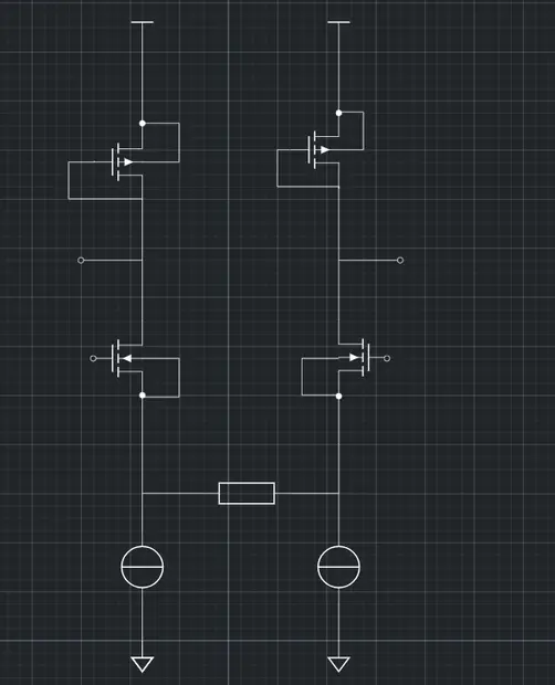

So im trying to find the small signal differential gain of this circuit
The input is at the 2 NMOS's above the degeneration resistor and the output is where the capacitors are hanging (excuse that I didnt label them, the program where I drew the circuit doesnt have that option).

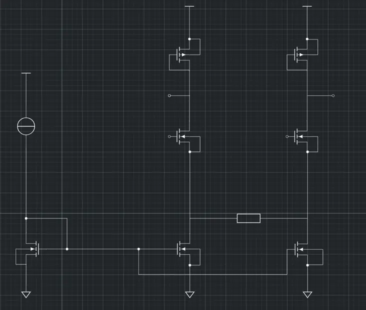

My approach was divide and conquer; I first wanted to look only at the "core" part of the circuit (excluding the Push-pull stage) and find the diff. gain of that part and than combine it all together;
This is the core part of the circuit
You notice that this has external biasing for the bottom two transistors that create a current mirror. This is not included in the original circuit since I wanted to preserve readibilty; but basically im biasing with an ideal current source with a diode connected NMOS. An equivalent, but simpler circuit is this
The bottom two NMOS transistors are as ideal current sources. The reason I prefer the core circuit to look like this is since something rather similar can be found in the book of Razhavi (design of analog CMOS circuits) and I have been able to understand how he tackles problems similar to this.
My simulation of the circuit has shown that I have perfecty symmetry so I opted to use the half circuit technique described in the Razhavi book. I just look at one side of the circuit and calculate the gain; the total gain is just that times 2.
So thats what I did; The top diode connected PMOS active load will act as an resistor with an value 1/gm (we neglect gds since it is significantly smaller) the current source will go to a virtual ground (explained in Razhavi) and the degeneration resistor will be "split" to Rs/2 on both sides.
Than we do the small signal analysis (if needed I can post the circuit diagramm) and I get the following result;
$$ \frac{Vout}{Vin} = \frac{-gm_N}{gm_P(1+\frac{gm_NRS}{2})} $$
where ## gm_N ## is the gm of the NMOS in the middle and ## gm_P ## the transcondutance of the diode connected PMOS
Now this is where I get stuck; I cannot incorporate the push-pullstage. I am not sure if I should draw the push pull stage seperatly and simplify as much as possible and add to my existing core circuit or do I have to do it in one swoop so to say?
Any insights?
Also what do you think of my plan to do the small signal analysis? And how is this looking so far.
Excuse the lengthy post and thanks in advance!

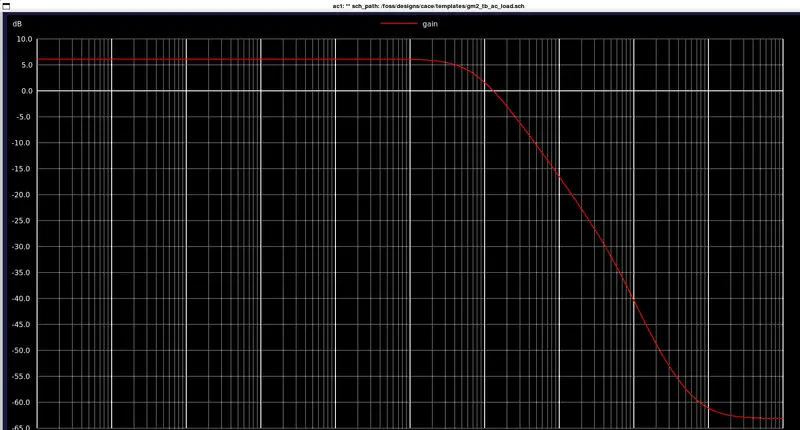

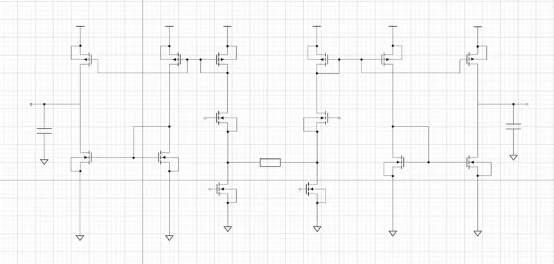

For the C; I first tried finding the transfer function without the push pull stage and since the caps are "hanging" at the output of the push pull stage I neglected them.
Now for the circuit itself; (I find it cool you remember my earlier post). I actually never crossed the mirror currents, the solution was adjusting the W/L ratio of the mirror currents in the push pull stage and implementing a degeneration resistor for the DC simulation.
In fact I have simulated the result I am looking for (the differential pair with push-pull stage and caps)
Here it is for a certain value of C and Ibias.
So the circuit I posted (now with NMOS at the bottom instead of PMOS) is the one I am looking for.

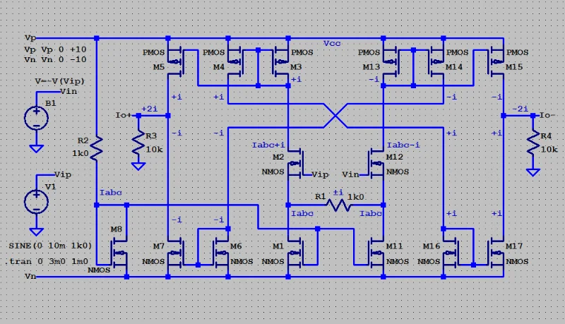

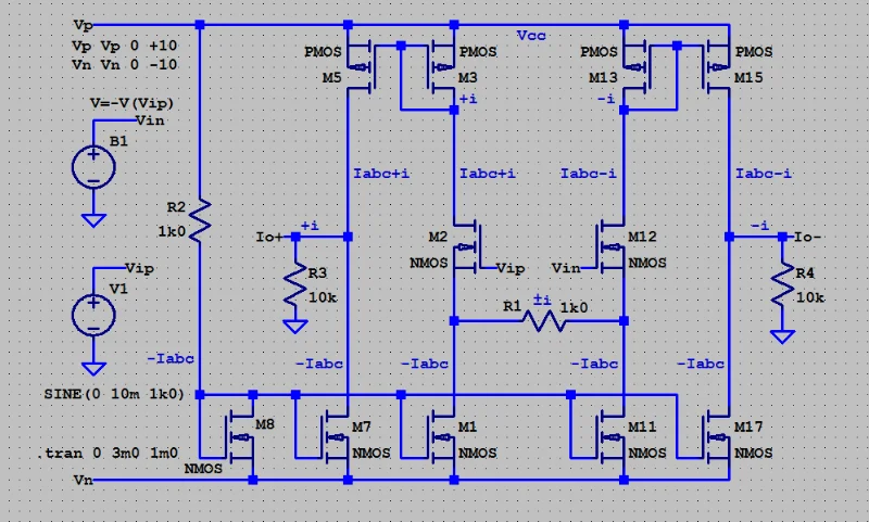

The output of a transconductance amplifier will be the difference of two almost identical currents in the circuit output.
There will be an amplifier bias current, Iabc . The differential input voltage will cause a current, i = Vin / Rin , to flow through the input resistor.
The differential input stage will then offset Iabc by +i and -i, giving,
Iabc+i on one side, and Iabc-i on the other.
There are two ways to perform the subtraction that makes the output independent of Iabc.
1. Subtraction from Iabc; by using a wide, multiple output Iabc mirror.
giving outputs of;
Iabc - Iabc+i = -i .
Iabc - Iabc-i = +i .
See No-Cross circuit below.
2. Subtraction of the opposite side of the input, by using a crossover,
giving outputs of;
Iabc+i - Iabc-i = +2i ;
Iabc-i - Iabc+i = -2i ;
See Cross-Over circuit below.
By making the MOSFETs asymmetrical, you thought you had fixed the problem. But you are now taking Iabc+i,
then multiplying it by a MOSFET mirror asymmetry, A ;
before subtracting the original.
Iout = A*(Iabc+i) - (Iabc+i) = (A-1)*Iabc + (A-1)*i .
That has NOT eliminated Iabc from the outputs.
That is the problem with your crooked circuit at the moment.
If all the MOSFETs were identical, then A = 1, and Iout = 0.
That was your original thread's problem, perfect cancellation = 0.
1. No-Cross.
2. Cross-Over.
