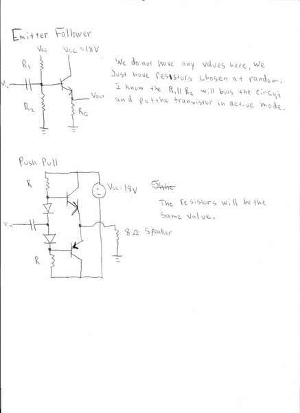

We do no know the impedence of the guitar my professor is going to use. We decided that a
buffer (an emitter follower) would be best to take care of that. We tried to get 1mA across the
emiiter, and I think we have it but I am not sure.

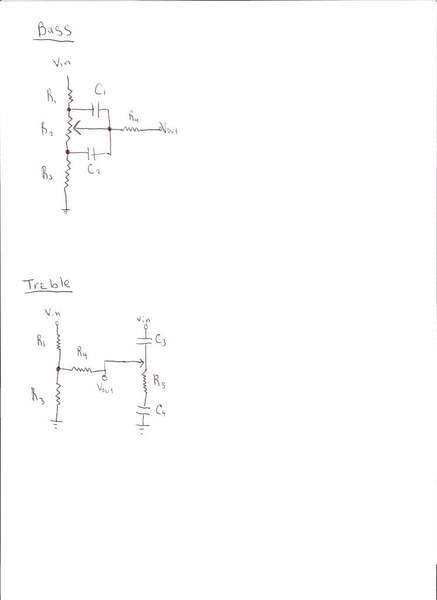

The next element in our design is a James Baxandall passive tone control network. We actually have one that works but not for the values that are specified in the lab document. (Normally, my two partners do analysis and I build. They attempt to build and I attempt analysis, but I am not strong with analysis and they never build until they do analysis. Thi causes us to have circuits that work but not for the values we should have. I litterally just pick random resistors and capacitors out of my shoebox and put them together. I learned a lot that way and have some interesting lab sessions.)

The amplifier then goes to a push pull which goes to the speaker.

Also, the output push-pull stage is a bit simple -- what could be added to increase fidelity (at the expense of a little more power dissipation in that stage)?
I know, it is really bad engineering to do that, there's really no excuse if I want to become an electrical engineer. Right now I am a second year student and this is only my second class toward my major. I really do not know how to answer you question about what I could add.

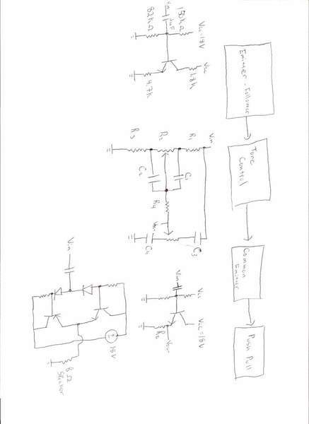

Hello. I have been having a busy Easter Week and that is why I have not been posting though I am very grateful for your insight. I do not have any SPICE program though (I find I can neverfind one is straight forward enough to use) and we have learned BODE plots. Is this what you were talking about when you said to have a block diagram (the attachemnt)? If so, I did have one in my lab book, I just did not scan in the whole lab entry for this project.in the whole lab entry for this project.

That's getting closer. The drawing is a little hard to read (do you have Visio?), but it looks to me like your treble and bass adjustments are not independent. Are they in series? You want an equalizer's adjustments to be independent. That is, adjusting the bass control should not change the treble passband, and visa-versa. How can you change your circuit for that block to achieve that?
No,I do not have visio, but I will try to di better for the scans. Since I have them separated will I now have to put them in parallel to the emitter follower and the common emitter, or do i have to build those separately, one follower and one common emitter for each? I there a SPICE program that you recommend to use?
