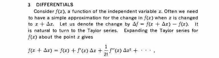

"Expanding the taylor series for ##f(x)##.." (See picture) is this a typo? Aren't we expanding ##f(x + \Delta x)##?
Also, when we evaluate ##f(x)## (coefficients in the expansion), are we assuming ##\Delta x = 0## by setting ##x + \Delta x## (argument of the function) equal to ##x##? Or are we just "replacing" ##x + \Delta x## by ##x##? I'm confused because usually when a function is evaluated at a particular number we just set the variable inside the argument of the function equal to that number, but when we're evaluating at "some other variable", for instance, finding ##f(x^2 + 1)## given ##f(x) = x^5##, we're not implying that ##x^2 + 1 = x^5##.

You are getting wrapped up in semantics. The whole thing is about expanding the function f in a series form. Whether this is f evaluated at x ( f(x) ) or f evaluated at x+Δx ( f(x+Δx) ) is not anything to split hairs over. The way it was written in the image is the standard way to write this, and in fact, it is the correct way as well.
What it says is that the function, evaluated at x+Δx is equal to the function evaluated at x, plus the additional terms shown. This is true.
Let us change notations just a bit. Let a and b denote specific numerical values fairly close together. Then the expansion says
f(b) = f(a) +f'(a)*(b-a) + (1/2)*f"(a)*(b-a)^2 + ...
Does that make sense to you?

I think you may be a bit unclear on the Taylor series itself and how it is being used.
The Taylor series gives an approximation to a function f(x) at any point x. It basically gives a way to model the function in a neighborhood of x (imagine x = a) by saying it is the sum of f(a) plus f'(a) x q plus f''(k) x r plus f'''(k) x s plus...
Now, at x = a, all of the terms after the first are unnecessary - f(x) at x = a is just f(a).
The benefit of a Taylor series is often to ask, if we know f(a), what f(a + delta) is, approximately, for small delta. To do this we add up those other terms and add to them the delta times the term.
