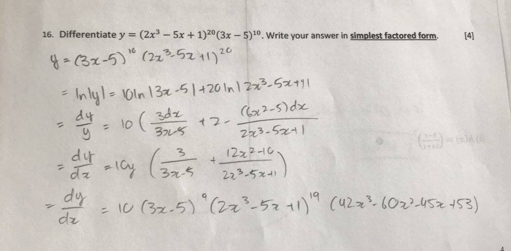

Differentiate 𝑦 = (2π‘₯^3 βˆ’ 5π‘₯ + 1)^20(3π‘₯ βˆ’ 5)^10. Write your answer in simplest factored form.
I've solved it..but I feel like it can be factored further?
n/a
I don't see any reason to use "logarithmic integration". Just the "product rule" and "chain rule" are sufficient.
[tex]y= (2π‘₯^3 βˆ’ 5π‘₯ + 1)^{20}(3π‘₯ βˆ’ 5)^{10}[/tex]
[tex]y'= 20(2x^3- 5x+ 1)^{19}(6x^2- 5)(3x- 5)^{10}+ (2x^3- 5x+ 1)^{20}(10(3x- 5)^{10}(3))[/tex].
Both third degree polynomials you end up with have real roots (they are polynomials of odd degree). I don't expect that you can completely factorise these into linear/quadratic factors as the roots will probably be quite ugly.

wow, this question can really be solved in one step like that?
I guess I will leave it as it is then.

Well, the quicker you try to do it, the more likely you are to make mistakes so perhaps you should check my calculations!
But it isn't in best factored form yet.
Nothing was said about factoring!

Look at the statement of the problem in post #1.
sorry for the late reply, but I think I got it..?
Just differentiating the equation via a calculator I got:
$$y' = 20\left(2x^3-5x+1\right)^{19}\left(6x^2-5\right)\left(3x-5\right)^{10}+30\left(3x-5\right)^9\left(2x^3-5x+1\right)^{20}$$
or
$$y' = 10(3x-5)^9 (2x^3 - 5x +1)^{19} (42x^3 - 60x^2 - 45x + 53)$$
