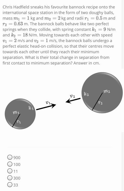

HI, I’m trying to get better at physics problems while I’m out of school. I’ve been trying these problems over and over and cant seem to get them. I dont have a teacher to help me so I’m wondering if any of you could help. I was hoping I could see how you solve the problem, and what answers you get. Thanks for the help in advance!!!

Diagram of two grey circular bannock balls approaching each other, labelled m1 with radius r1 and spring constant k1 on the left, and m2 with radius r2 and spring constant k2 on the right; velocity arrows v1 point right and v2 point left, with answer choices 900, 100, 11, 300 and 33 below.
