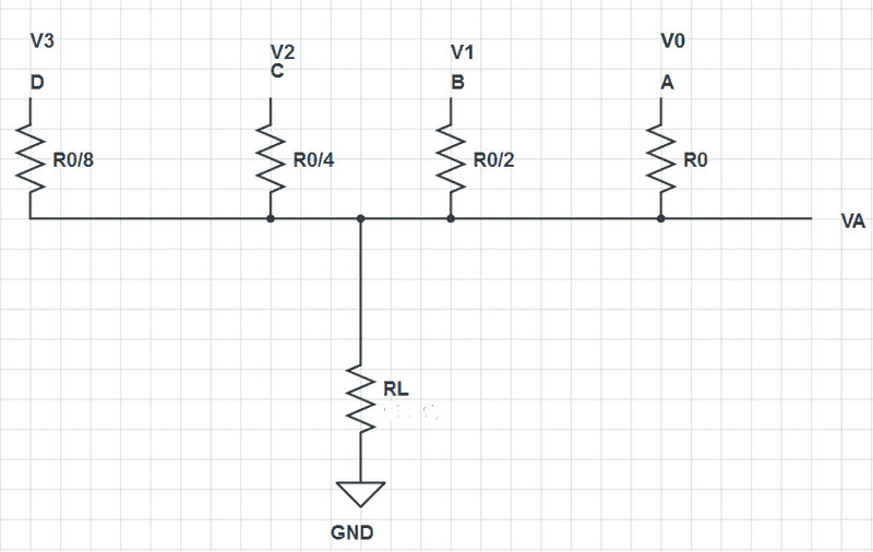

Hello PF :smile:
i am stuck with a concept of weighted resistor D/A converter.
For a 4-bit resistive ladder,
VA={V0/R0+V1/(R0/2)+V2/(R0/4)+V3/(R0/8)}/{1/R0+1/(R0/2)+1/(R0/4)+1/(R0/8)}
I want to find out how the equation is derived but have no clue.
Thanks.

Write the equations of this circuit and solve.
For example:
V0 = R0 i0 + RL iL
iL=i0+i1+i2+i3
finally i have ended up with this:
VA/RL=V0/(R0+RL) + 2V1/(R0+2RL) +4V2/(R0+4RL) + 8V3/(R0+8RL)
Any way to get rid of RL??
rude man said:
No. Assume RL=0. What would VA be then?
thanks for the reply :smile:
if RL is zero then VA would be grounded and hence it will be zero.
Right. So VA depends a lot on RL, does it not.
So your given answer can't be right.
So now let's do it right:
Sum currents at VA to zero: (V3-VA)/(R0/8) + ... = VA/RL.
Fill in the blanks. and solve for VA.

i have got that equation on Post No. 4
here is the equation:
(V3-VA)/(R0/8) + (V2-VA)/(R0/4)+(V1-VA)/(R0/2)+(V0-VA)/(R0)=VA/RL

My textbook says """ Resistance RL represents load to which divider is connected and RL is considered to be large enough so that it does not load the divider network.
VA={V0/R0+V1/(R0/2)+V2/(R0/4)+V3/(R0/8)}/{1/R0+1/(R0/2)+1/(R0/4)+1/(R0/8)} """
nil1996 said:
so does RL>>R0 affects the equation?
If RL >> R0 then RL drops out, approximately.
So then, compute VA for RL >> R0 ...
I have the answer if you want to check yours ...
PS R0 drops out too ... which is obvious if you look at your given solution. Multiply numerator and denominator by R0.

nil1996 said:
Can you explain me how RL drops out?
And what does it mean by ""RL is considered to be large enough so that it does not load the divider network.""
Solve the equation in your post #9 for VA. Then let RL >> R0.
That will answer both your questions.
(The divider network is R0, R0/2, R0/4 and R0/8.)
solving that i get
(8V3+4V2+2V1+V0)/15=VA
thanks a lot!:smile:
I got it.:thumbs:
(My textbook should have stated that it is appox.)

A finite RL reduces the output voltage by a constant: R0/(15R0 + RL) instead of just 1/15.
The idea here is that in a real application there will be some finite value of RL; this computation shows that it should be >> R0 or the output voltage will be a function of RL which makes the d/a converter inaccurate since RL is usually not constant.
