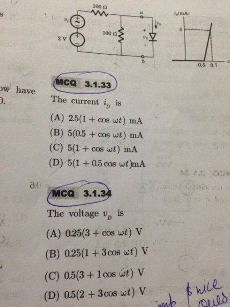

Diode numerical (calculation of current and voltage across diode)
9 replies · 6K views · last reply
lazyaditya
176

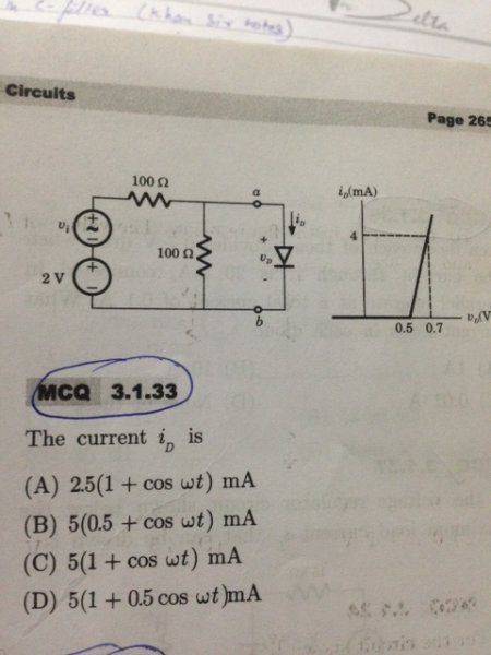

The Diode in the circuit shown below has the non linear terminal characteristics as shown in the figure.Let the voltage be "coswt" V . Question 3.1.33 and my attempt is shown in the figure.

The formula ηVT / Id is the slope of a Si diode's exponential V-I characteristic, and gives the Silicon diode's small signal resistance. You don't have a Si diode for this question, you have some clunky diode whose V-I graph has a fixed slope regardless of Id.
I would much prefer that you typed out the text of a question, rather than forcing me to jockey back and forth between multiple graphics (and wasting my 3G data quota unnecessarily in the process).

AC is synonymous with "small-signal" and also "incremental", it imposes what amounts to just a tiny wobble in the DC. So this small wobble does not see the 0.6 V cut-off, it sees just how the current increases for a tiny increase in voltage: the dynamic resistance or incremental resistance, and this is the slope of the diode's graph at the DC bias point.
Of course, you should from the outset confirm that the AC component really is small compared with the DC. There may be occasions when an examiner deliberately sets a trick question to catch anyone not fully awake.

Since you're given multiple choice, you can proceed as follows:
Let Vin = 2 + 1 = 3V (highest input voltage)
Sum currents to zero at the anode
write expression for diode current assuming v > 0.5V. This should be obvious from the diagram.
Solve for diode current, then diode voltage.
