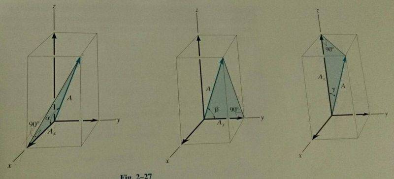

In this question, I didn't see why the given 90 degree is 90 degree becoz it doesn't look like 90 degree. Can someone draw me a better diagram? It's hard to visualize it's 90 degree

Well it's trying to represent an angle measured in a 2D plane in 3D space on a 2D piece of paper. So it will always look skewed when the plane is not the same as the plane of the paper.
They are trying to illustrate the 90 degree angles in 3D space. A common way to visualize this is to subractthe Z component, and you will clearly see the right angles in the x-y plane.
The angles are 90 degrees by definition. You should not question it just because when it is illustrated at a skew angle it doesn't look like the square angle you are used to.
The method being used is one that involves drawing a perpendicular line from the end of A to whichever axis you are interested in. Since your new coordinates are defined with angles to the vector A from a given axis, the definitions are given in terms of cosine(angle) = adjacent (axis) divided by magnitude (vector).

well , i still don't understand . take an example , alpha already more than 90 degree. How can the other angle be 90 degree? Can you explain in other words , so that i can understand better ?

How do you know alpha is more than 90° ? Remember, these are not plane triangles you are looking at. They are triangles in three dimensions which are drawn on a two-dimensional page.
A better way to look at these diagrams is to imagine that the right angles are showing that there are three planes which are parallel to the x-y plane, the y-z plane and the x-z plane and which are also perpendicular to one another.
I suggest you cut a corner off a piece of paper and view it at different angles to replicate the drawing views.
