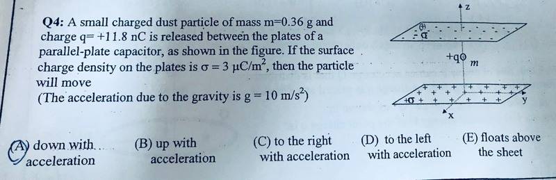

Physics problem Q4 with a diagram of two horizontal parallel plates, the upper negatively charged and the lower positively charged, with a small charged particle m+q between them and a z-y-x coordinate axis. Answer options (A) to (E) are listed below.
Three equations typeset in plain text: Fg = mg, E = σ/ε0, and Fel = EQ, the last cut off at the right edge of the image.
Three lines of worked calculation: Fg = mg = 0.36 * 10^-3 * 10 = 3.6 * 10^-3 N; E = sigma/epsilon0 = 3 * 10^-6 / (8.85 * 10^-12) = 338.98 * 10^3 N/C; Fel = EQ = 338.989 * 10^3 * 11.8 * 10^-9 = 4 * 10^-3 N.
Since Fel > mg , the particle will move up with acceleration

Nguyen Son said:
What is your question?
want to know where is my mistake as I didn't get the same answer as the model answer
Your calculations and conclusion look okay to me.
My answer turns out to be correct;Thanks !
