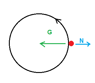

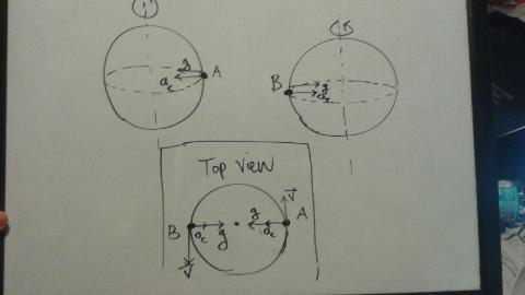

Im picturing a stationary object at the equator of the earth, going around in uniform circular motion due to the Earth's rotation. The centripetal acceleration would point directly inwards into the Earth at all points in the circular rotation, and gravity would also point in the same direction.
This is how I am visualizing it. I have read that the accelerations oppose each other, but I cannot picture why.

Which ##“other force”## are you talking about?
I see what you're saying, but I am still confused. In the problem I posted above, the radial acceleration due to the Earth's rotation is apparently pointing outward, but I don't see why it would. The acceleration is supposed to point into the circle, the circle being the path traced by the Earth's rotation. I drew a picture of how I thought the problem was so maybe you can see the error in my reasoning

You do not need centrifugal force, if you use a rest frame of reference. There is a body on the equator, moving together with the Earth, on circular path. Knowing the radius of the Earth and its angular velocity, you can find the radial (centripetal) acceleration and the centripetal force needed to that circular motion.
The centripetal force is the resultant of the force of gravity and the normal force acting on the object by the surface of the earth.
If the Earth rotated so fast that negative normal force would be needed to keep the object on the circle of radius R, the object would fly away from the Earth surface. The minimum speed is when the normal force needed is zero, so the froce of gravity is equal to the centripetal force.

No, they both point inwards. Gravity provides the centripetal acceleration, but at some spin rate the required centripetal acceleration would be greater than gravity can provide. You have to find that spin rate.
